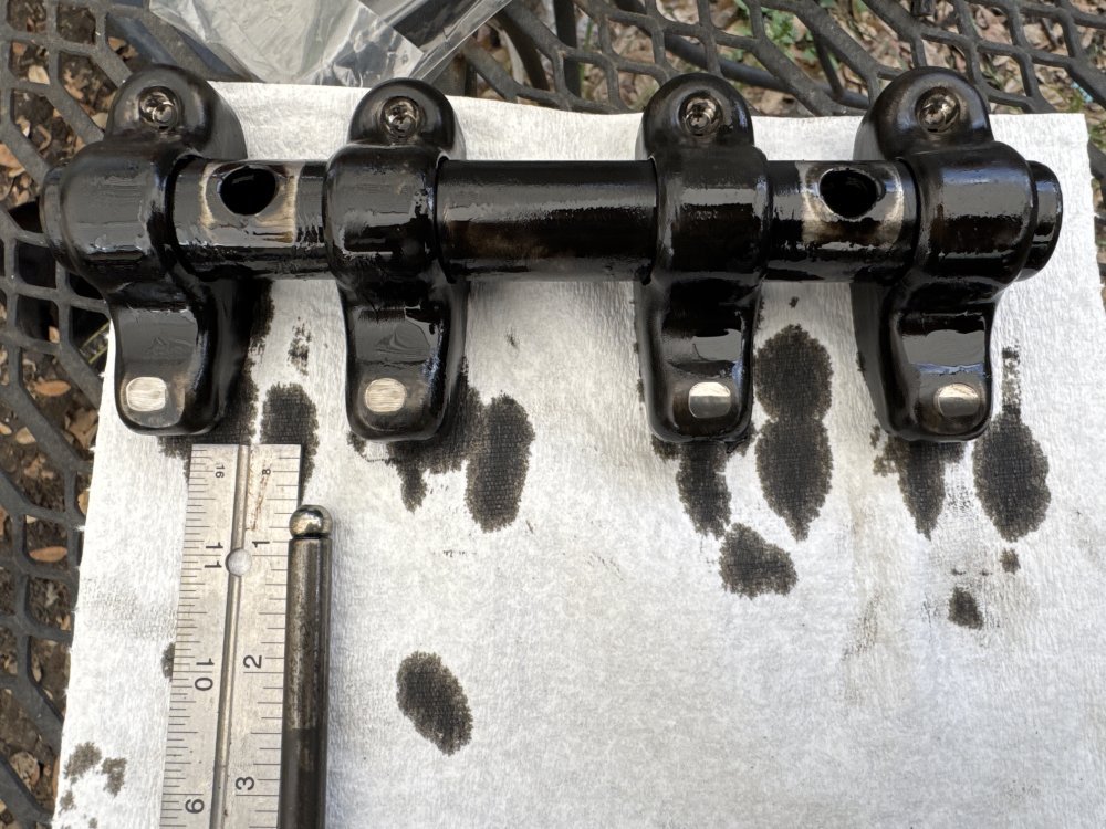

Pulled the one that was doing this and used my straight edge. Confirmed it’s not bent.

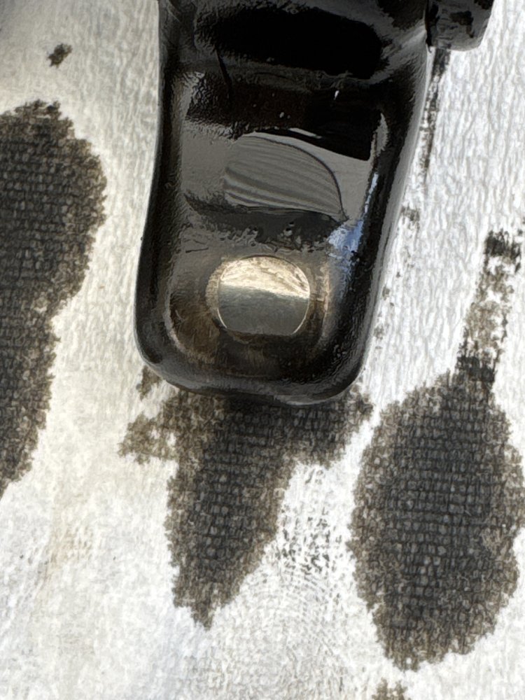

How critical is the wear on the rocker to shaft or the wear on the ends where it contacts the valve?
Here’s a pic notice the wear pattern where they contact the valves. The second and fourth you can see and feel the impressions

No bent push rods, retainers are intact. Don’t think there is much of anything I can do about the wear. Still have the driver’s side valve cover to pull and inspect but I’m thinking of just verifying retainers are intact and slapping it all back together. Was gonna do the bolt mod in place of the retainers but with the condition of this engine I don’t think there’s any point in doing the bold mod for the rockers unless others disagree.
I feel like the engine is gonna fail before these plastic retainers do!

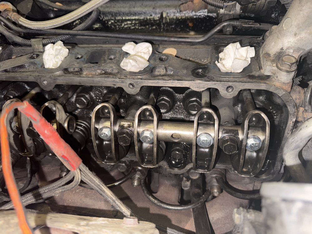

For me, its a 'while I'm in here' thing. I'd do the bolt mod because you don't know when you're going to either 'do things right' or one of those old plastic retainers is going to decide your next course of action for you. Bolts will cost you what 15 - 20 bucks? Cheap insurance and you can re-use them on the next engine...or not.
Yeah your right, who am I kidding here LOL. considering home depot is within walking distance to my house I might as well go get some hardware. I already did this to the 95 way back with good results.
16ea 1/4"x3/4" grade 8 bolts, 32ea 1/4" flat washers (doubled up on each) that should be right at 3/4" diameter, and 16 nuts along with a tube of red lock tite. I remember doing this to the 95 and couldn't find any steel lock nuts, I will look and see if they have any.
I pulled one of the retainers out and didn't break it. the lower area of the rocker has some wear but there's not much I can do about that.

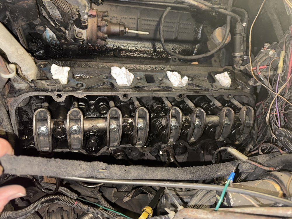

pulled off the drivers side valve cover and all looks good there too, still no smoking gun as to why I am hearing what I think sounds like a lifter randomly collapsing under load. I somehow doubt that is what I am hearing though, oil pressure stays in the 40's under load and only drops to around 20 sitting at a stop when warm. I'm sure once I get it back together again, later some miles down the road it will rear it's head, get louder and more consistent so I can be under the hood to hear it. or see a rod fly LOL.

Wear on the entire valve train... weak lifters, ware on rockers, ware on valve tips, ware on valve seats, week springs....
It all loosens the preload on the lifter, say new preload is .050" new .. now you may have .020", the wore out lifter doesn't stay pumped up as well...
The fact you stated it goes away when you vary the load on the motor points to lifters as the main culprit transferring the lack of preload to the rockers...
Get the picture...
Went fourth with the bolts nuts and washers. Need to get it back together by Sunday night. Can’t get replacement plastic retainers that quick!

Got the rocker assemblies finished and installed. Torqued down. Cleaning up the valve covers now and checking with a straight edge.
