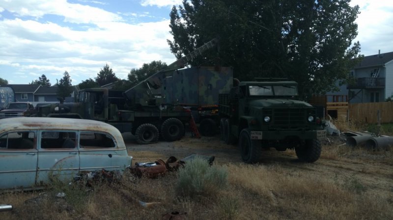

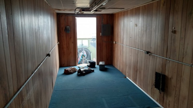

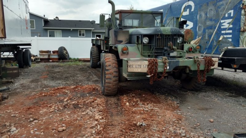

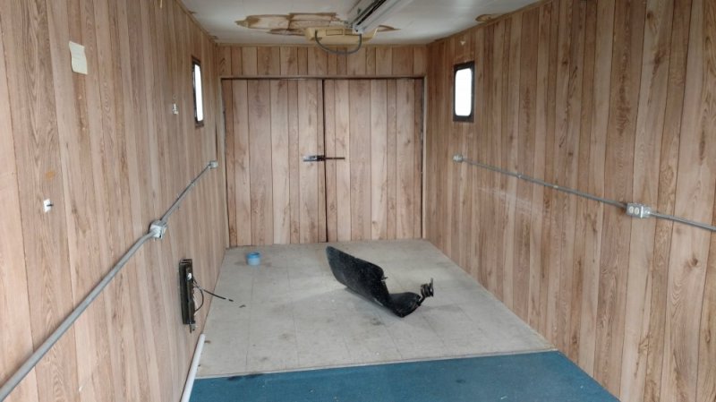

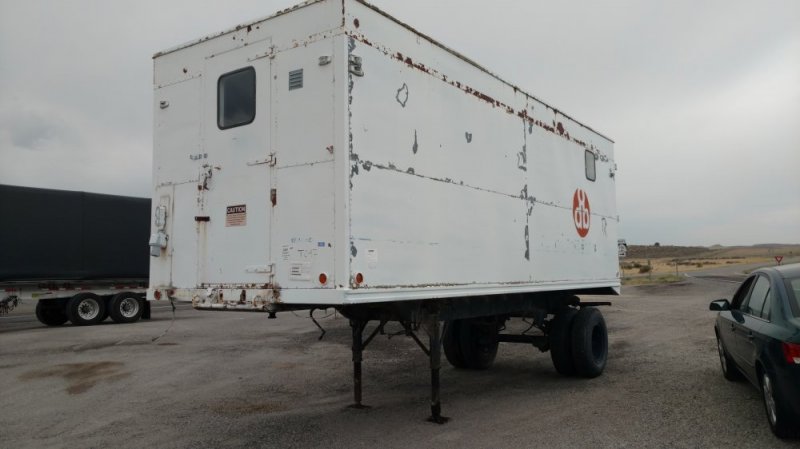

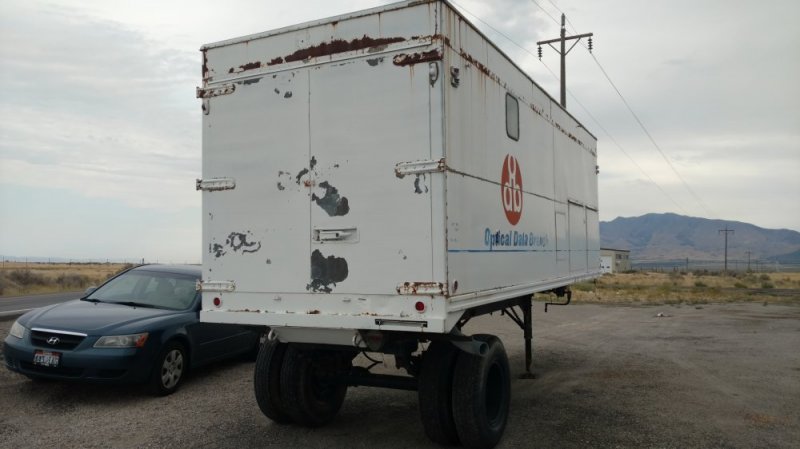

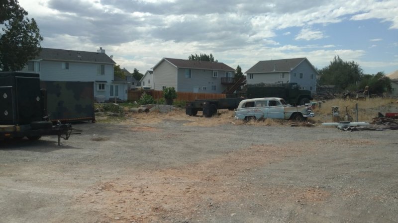

Picked up this trailer for $2 at auction back in August. Using it for storage until the wrecker bed, 5th wheel tractor bed, and the 4bd1t swap projects are done. Then I'll start with the camper build. The trailer is light enough that the pickup can pull it, just can't activate the air brakes on it.
IMG_20170831_100022500.jpg IMG_20170831_100203372.jpg IMG_20170831_103840848_HDR.jpg IMG_20170831_103851122.jpg

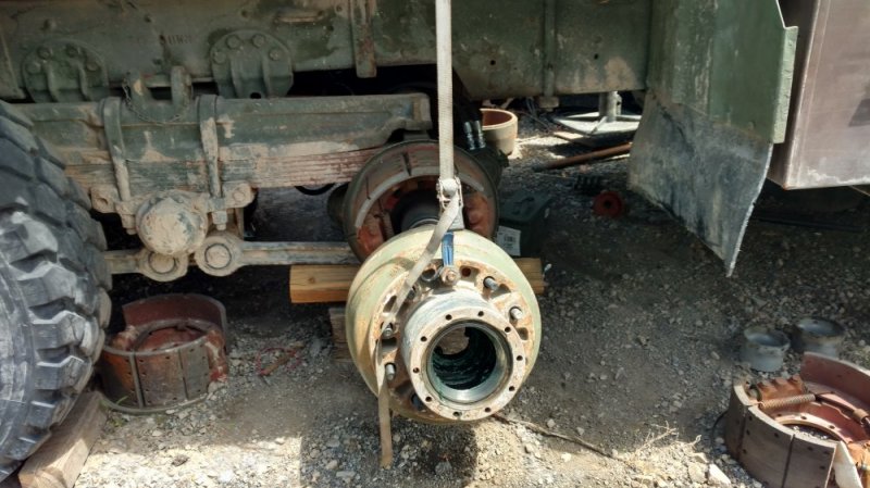

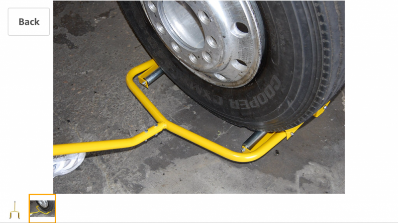

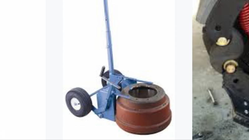

Heavy stuff does have it's benefits though. More space to work on stuff (can sit upright when under the truck), and with it being as heavy as it is you're kinda forced to find ways to 'work smarter not harder'. Like the inboard brake drums/hubs, they weigh over 160 lbs each. Could strain and pick them up by hand, but I just use a come along hahaha. (pic of early setup using a ratchet strap, same concept).
Make a tire dolly with attachment for brake drum- I bought a super single dolly like the one in pic and weded on couple tabs for brackets that hold drum. One of best semi tools I ever made. Sold it for $150 and used single tire dolly(for my hummer) when i got out. Use bigger tires like drum dolly for dirt work when needed and easier leverage.
Old drums makes good grinder/vice stands too.
I use a piece of 3/8ths or 1/2 inch flat, drill holes in it to match several of the lug holes in the drum, weld My pipe stand onto the flat then boltum down. Works good for the small stuff I have in the garage anyway.

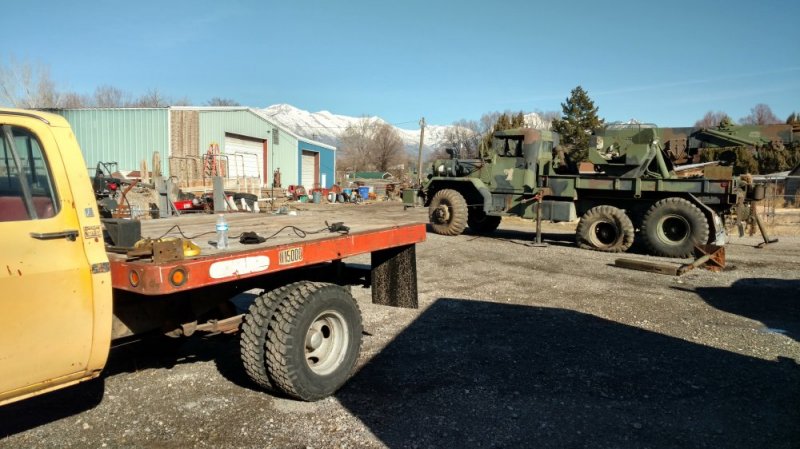

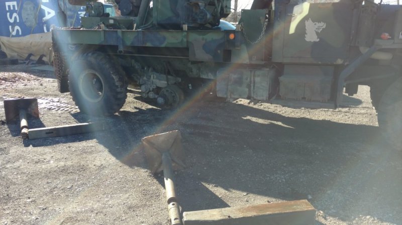

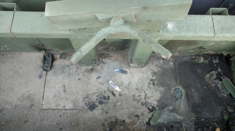

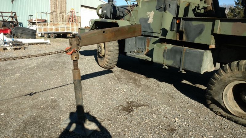

Stuffed in some lumber between the chassis and the bed sub frame, then lowered the manual outriggers for the last time. Drove the wrecker forward and used the bed winch on the pickup to pull all 4 outriggers off of the truck permanently.
Then did the measurements for the winch that will be used to load/unload the beds and starting cutting out the front section of the bed to make space for it.

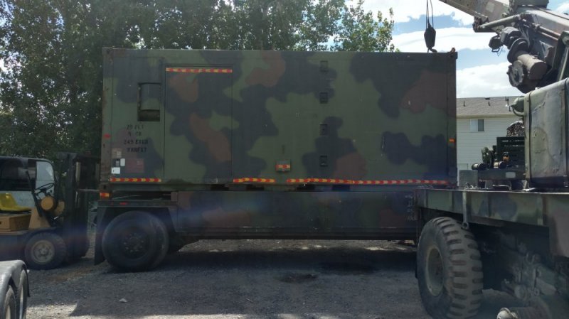

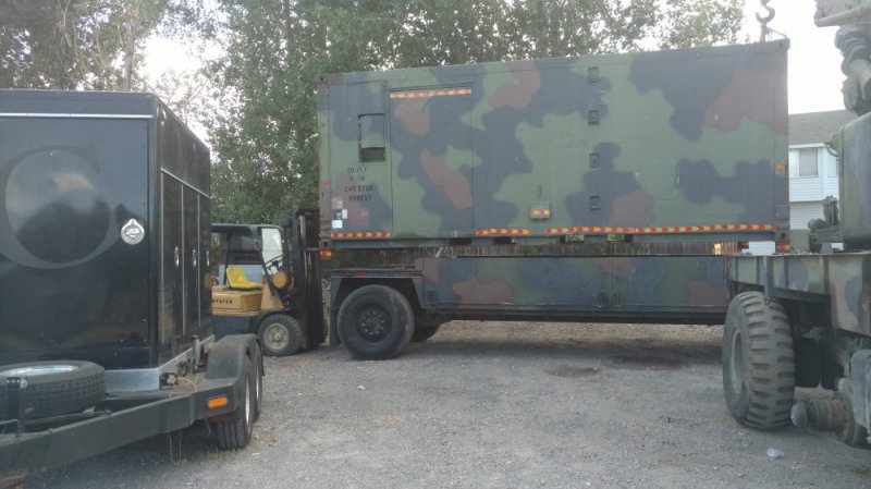

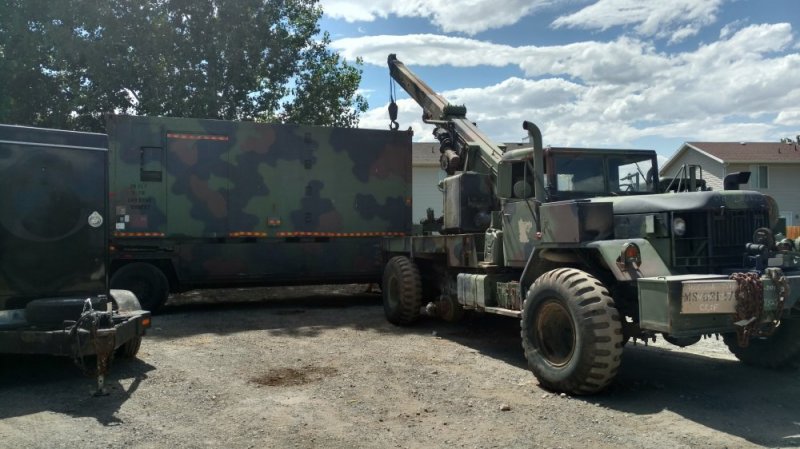

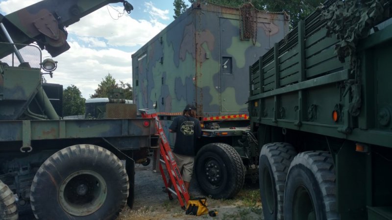

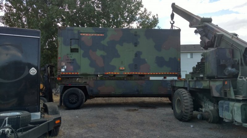

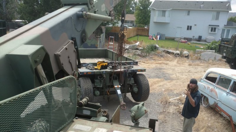

Got some use out of the wrecker today. Reattached the bed and it's PTO components last week. Weight wise the wrecker could have handled the entire 20ft container by itself but I don't have a spreader bar that wide and the crane doesn't go high enough for that. So the forklift was used at the other end. Everything went smooth with the unloading.
This was the one hickup in the whole thing, backing up a wagon trailer haha. So rather than spend awhile learning how to do it decided to disconnect it from his truck and just use the wrecker to make it turn.
Great work Red, who is your helper in the picture, I think he has me beat on the beard and the hair.:)
Haha That's my friend Josh. His property. Last year he bought that trailer with the container welded to it with plans to eventually take it off the trailer and use it for storage. And we finally got around to it hahahaha. Going to do the same thing to the white box trailer in a few weeks when the ground gets leveled out along that fence line.
Moving CONEX's like that is what the 20T Tactical Crane is for. My old unit in Desert Shield/Storm had four of them, they unloaded and moved hundreds of them a day filled with rations for the 500,000 Allied troops deployed over there. You need to find a surplus crane to go with your wrecker.
