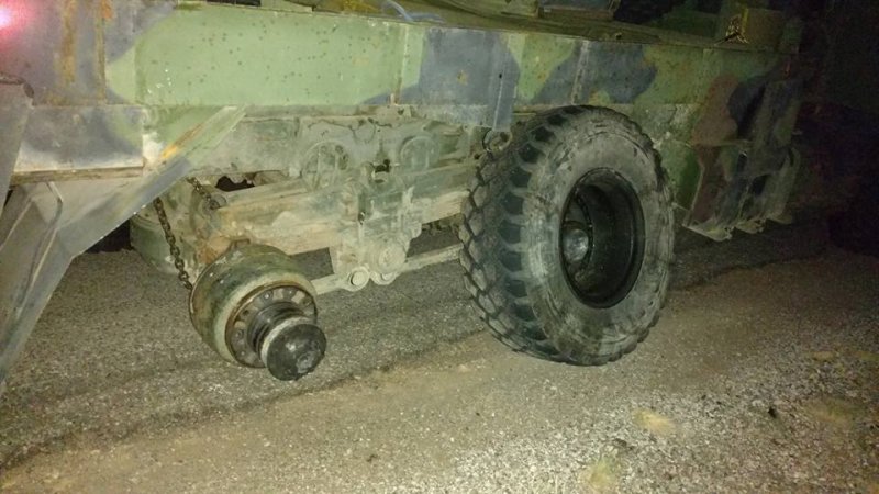

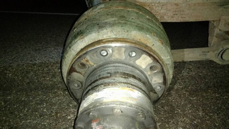

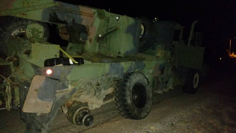

Well, this morning sucked ass to put it mildly. 20 new wheel studs sheared off while driving on the highway, destroyed the wheels as well. 3rd axle went first at 50-55mph so stopped to chain it up and limp off the interstate. Less than a mile later the middle axle did the same thing.
No wheel wobble or signs of loose lug nuts. Shop Forman was trying to figure it out, I'm thinking bad batch. 250 miles.

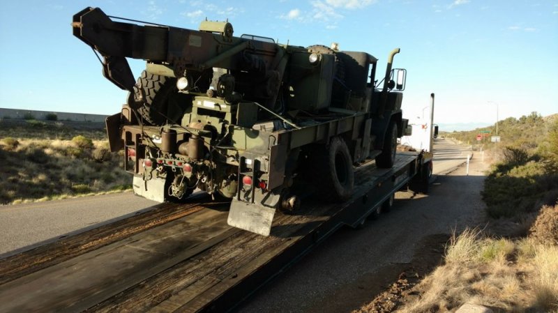

Do we even want to know the tow bill for that? I was wondering what you would use to tow it...
Oh man. Sorry to hear that. Sounds like a bad batch of studs for sure if that happened to all of them
