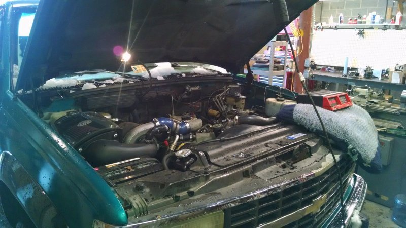

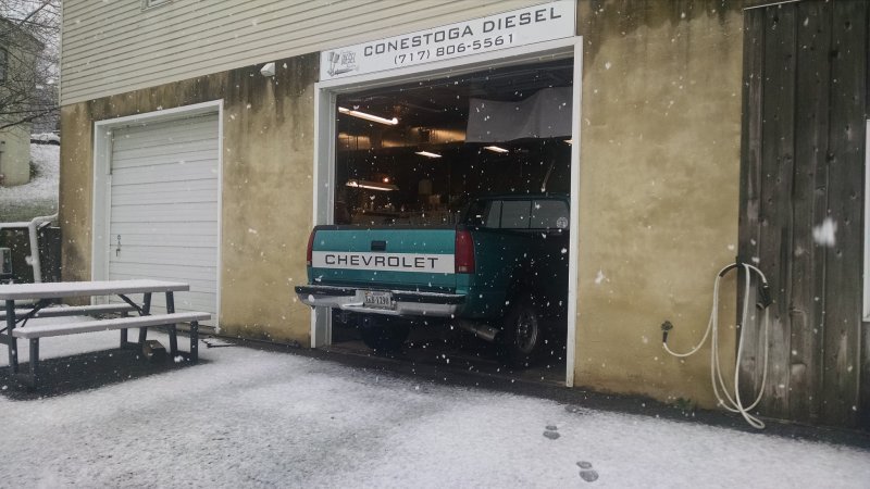

IMG_20141126_114123549.jpg IMG_20141126_122532663.jpg IMG_20141126_112514603.jpg Left for New Jersey this morning at 5am. Started out as rain and quickly changed to snow- the truck did great in the snow, ran the speed limit most of the time! Back to the subject at hand. Arrived at Conestoga Diesel around 11am- GPS told us to turn left when we should have turned right and they were out in Mennonite farming country- a whole lot of nothing. The folks at Conestoga were awesome- very friendly and accommodating- we had broken a wiper blade in the heavy snow and they even ran to the closest parts store for us to buy a replacement. I would recommend them to anyone looking for a quality reman pump.
The Bull Moose was 6^ retarded. Conestoga Diesel advanced the IP 6^ from where I brought her in and what a difference. WOW!!! More power and more off the line snap! Egts, Ects are lower. Oil pressure seems to a bit higher as well oddly enough. Definitely worth the trip. May even get some better mileage if I can keep my foot out of the throttle! I have been driving her a bit harder now that I have gotten used to the trans and the clutch. I am also feeling more sure of the mechanical state of the truck as the miles have racked up.
