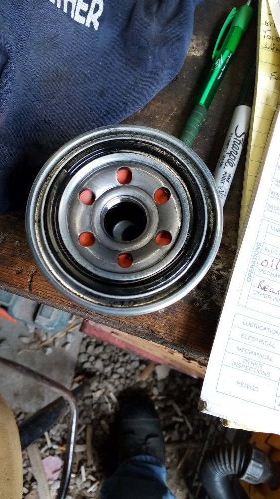

220D
I drained the oil.
Removed the filter. No oil came out of the filter. No oil came out when I set the filter in the drain pan, hole side down.
I never saw such a thing before.
I can't believe it would mow for about 4 hours without oil pressure or circulation and not exhibit major engine failure.
Napa Gold 1334 filter
I am going to remove the filter I installed and crank the engine.
It appears the front crank seal is leaking, but not bad enough to mess with now
220D
I drained the oil.
It was the filter. When I cranked with no filter there was plenty of oil there.
I never heard of such a thing before and still don't understand it.
The filter looked exceptionally clean.
I am guessing stuck bypass valve.
I never looked it over.
It's like the clean oil got there, but never got into the filter.
I thought it was odd when I loosened the filter and there was no black goo running down the side of the block.
When I cranked it over without a filter plenty of oil was going to the filter .
Going to losen this filter up and see what happens.

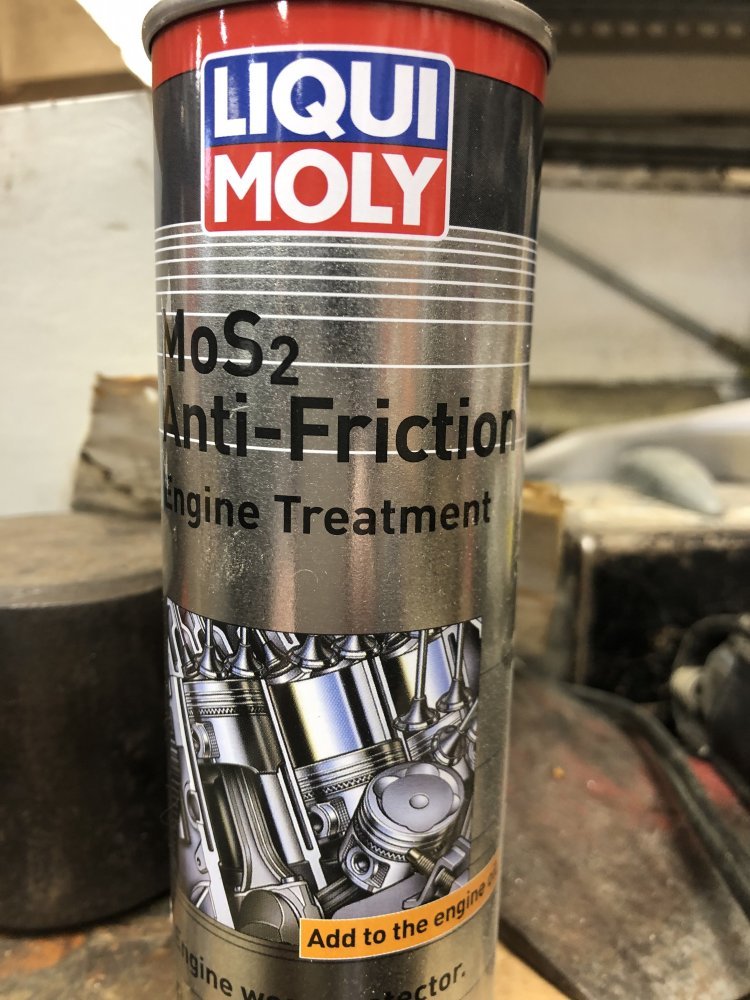

Here is some stuff that might help, after using the rislone to get the rings, etc, loosened back up and maybe some scuffing on pistons and cylinder walls sort of filled in a little.
If You try this stuff, do it after the other engine treatments.
This moly lube builds platelets onto surfaces.
If it will help Your engine I dont know. I dump a can to every oil change on my truck and it had not harmed it. 🤷‍♂️😹😹😹
