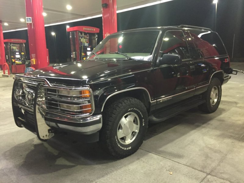

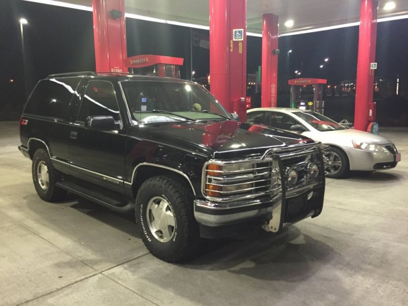

I need help with another vehicle I want to use as my daily driver. It might be off topic because it's not a 6.5td. But it's still one real sweet 1999 Chevy Tahoe Z71 5.7 Vortec with the towing package. I picked it up from the second owner who bought it 12 years ago with only 77,000 miles. It's still got the window sticker and owners manual sitting on top of the RPO code sticker in the glove box. She's got 179,000 miles and a Superchip Cortez tuner in the center console. Only mods I know of are flowmaster exhaust and the PO said it's got a Yukon Denali post rear end with 3.73 gears. The AC system has recently been redone and he took meticulous care of this Tahoe. It drives like new and is in real good condition.
Now the problem with the truck is when I go into 4hi the truck shakes real bad under any acceleration. The PO told me that's the 4 wheel drive is very aggressive because of the posi traction rear end. I never really used 4 wheel drive in my life but I know my Suburban doesn't do that! Anyway it's a real nice truck in great shape and she runs like brand new in 2 wheel drive.
Since I've gotten her home I took off the go Rhino stainless step bar from the front and the two 6 inch KC HiLites. I'm currently selling them on CL for $450 bucks for the step guard with the lights.
Well I spoke to a buddy of mine. I figured out the problem with the 4 wheel drive on the Tahoe. Different gear ratio in the rear vs the front. Going to pull RPO codes and get myself a rear end from the local junk yard that matches my RPO codes.
My guess is that your front diff is 3.42 and of course your rear is 3.73. The front half is trying to drag along the rear half when you're in 4Hi (or conversely, the rear doesn't want to stay caught up with the front).
Yeah well Now I spoke with the PO he says the rear in the truck he ordered from summit racing and its the correct gear ratio just has heavy duty springs and it drives fine in sand or snow just really aggressive on dry pavement. Can that be true?

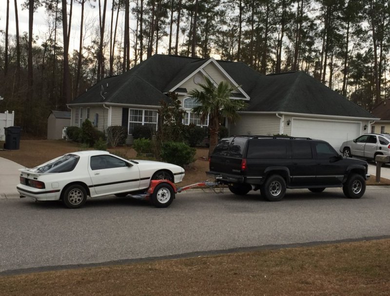

That's pic is of a parts car I bought. A 1988 Rx7 for 400 bucks it had a blown engine. Needed parts for what sits in my garage. A 1991 RX7 Savanna with only 54,000 kilometers which I had imported from Japan.
