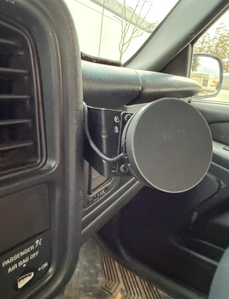

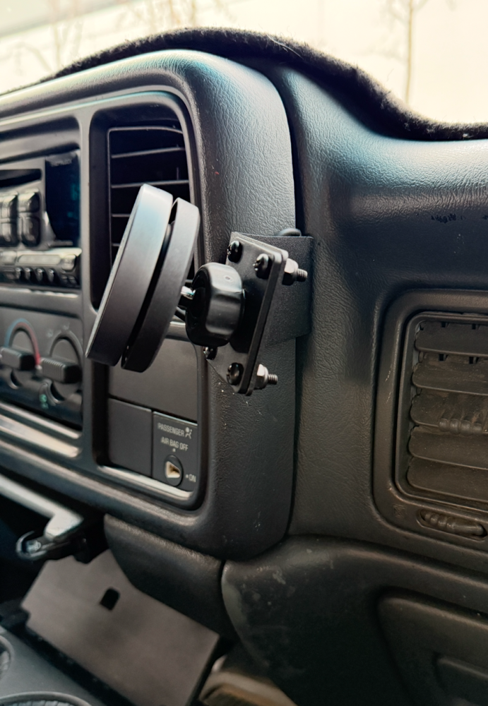

Also got a magnetic charging phone holder installed as I have started driving this more.

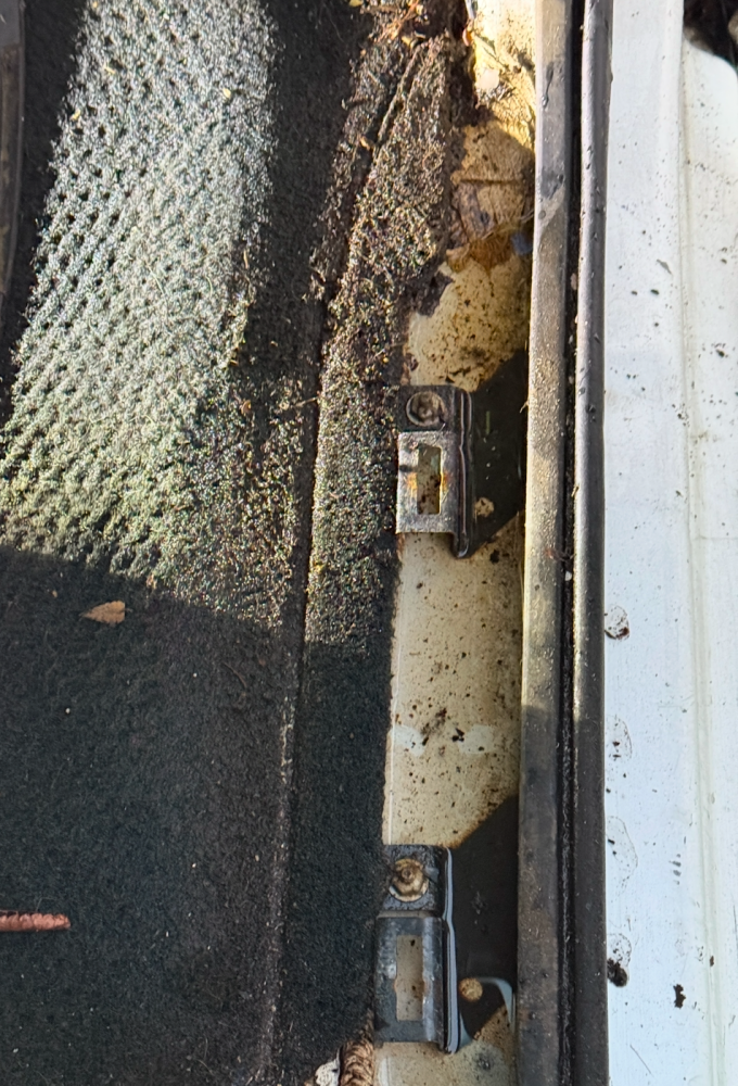

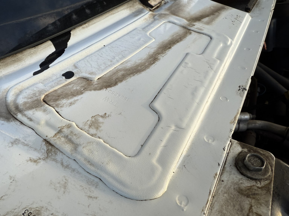

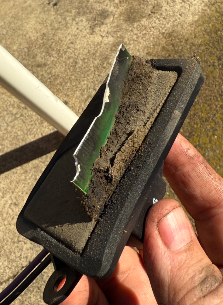

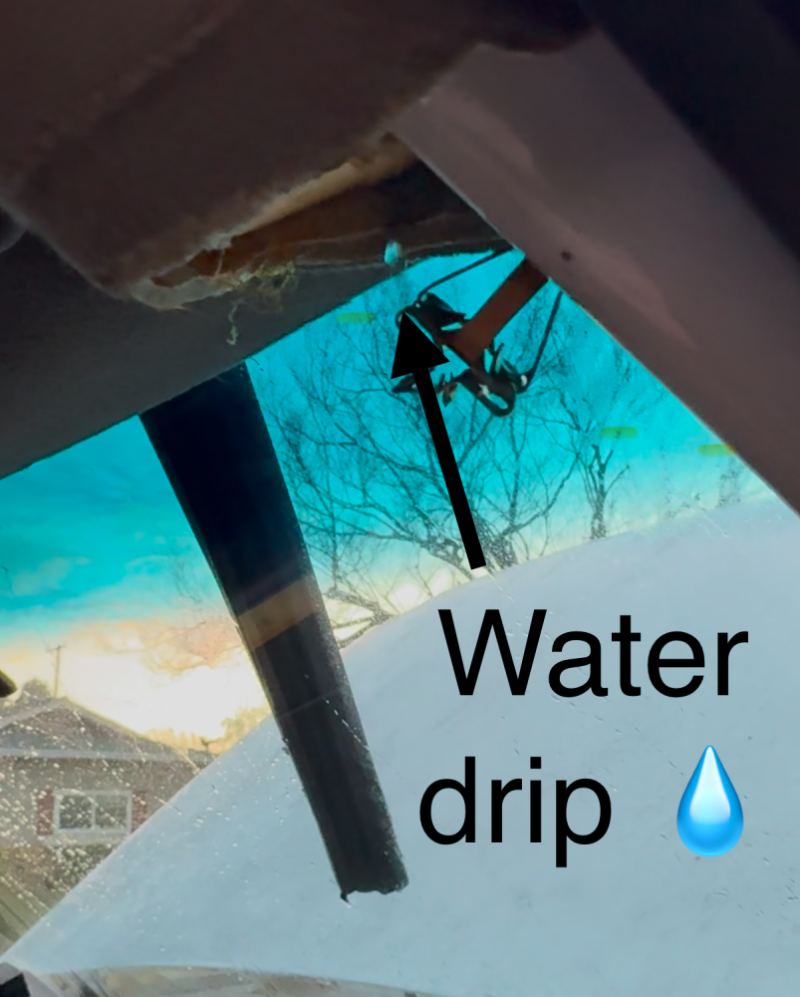

Well the rain today added something to my project list and may change my priorities. I was planning to look at the blower motor, controller and resistor but located a pretty decent water leak on the passenger side. It seems it’s coming from maybe the base of the windshield on the passenger side. Hard to locate precisely with the rain still falling today.
It seems the water leaking from the windshield area down the right side a pillar and behind the kick panel to the floor/door sill channel. My best guess at this point is the water leaking is hitting the blower motor or resistor and/or the connectors. So before I tear into that and replace parts I need to address the water leaking issue.
Probably be best to wait for the rain to hold out so I can pull some panels and try to locate the intrusion point by controller where the water comes from.
Find a smoker. Someone that smokes cigarettes, or, buy a pack and light one up, have someone drive the vehicle, hold the cigarette close to the suspected area. The smoke will be sucked out through the area where the water is coming in from.
An old trick I was taught back in the day when smoking cigarettes was cool, some pot too. 🫣😹😹😹
If You cant find a smoker, then see if You can find one of those punks thats used to ignite fireworks, or, maybe a smoking hot gal, but thats an invisable kind of smoke and dont work so good for leak detection. 🫣😹😹😹
Oh yeah, The vehicle most likely will need to be taken up to a decent highway cruising speed for the experiment to work.
Unless its the smoking hot gal experiment, then an out of the way parking place might be suggested. 🫣😹
