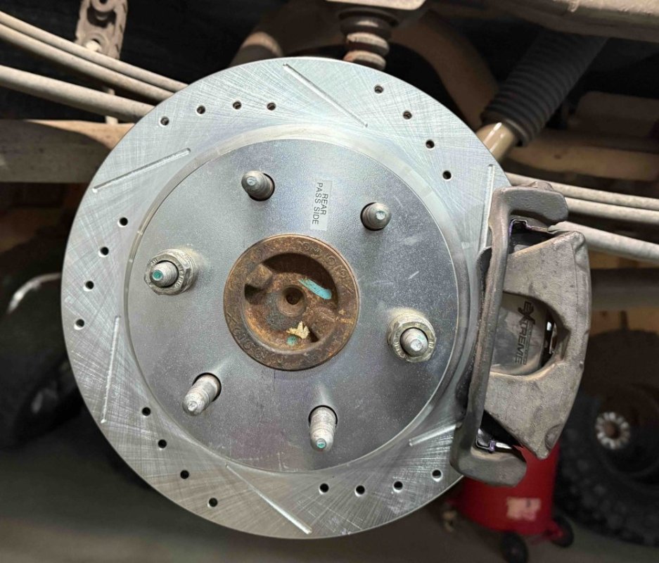

I hear ya on the rotors. I’m not usually a fan of these but everyone seems to like the powerstop extreme pads and rotors so these came as a set. If these don’t impress me I’ll likely replace them with regular ac delco solid rotors and pads which have always treated me well.

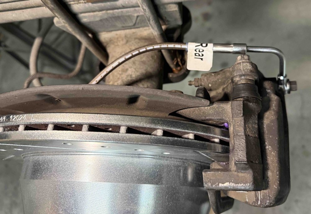

Got the rear pads rotors and brake lines all done. Got them bled and started on the fluids.
No real excitement on the fluid changes. For being over 1/4 million miles and not a very regimented maintenance schedule they fluids were dark as expected but nothing alarming. Got it all buttoned up and back on the trailer to drag it home. Then off to alignment this week and probably time for spark plugs, wires and o2 sensors. Then time to put some more miles on it.

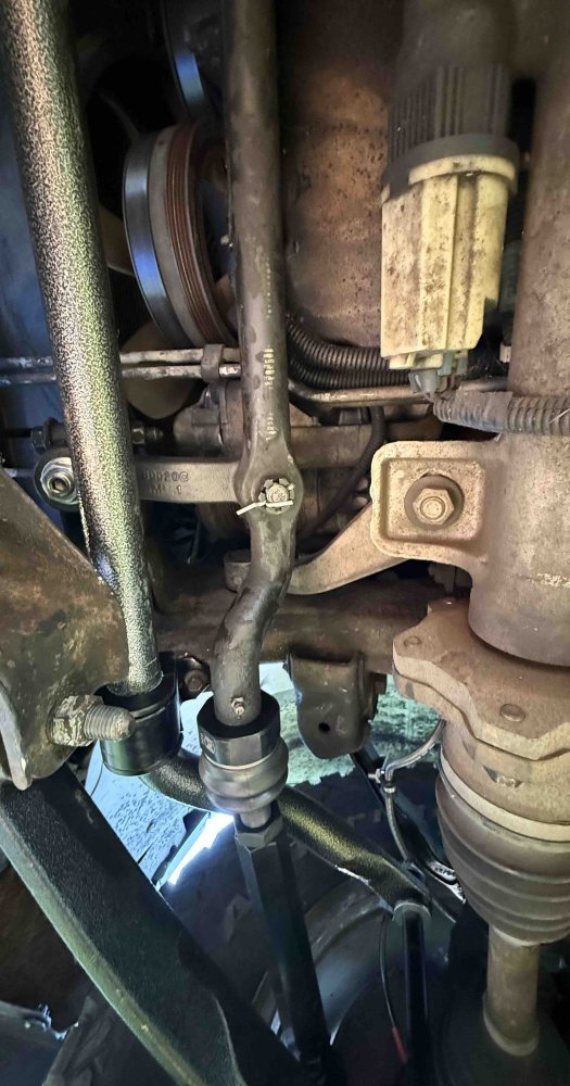

Got to drive the truck around today and something felt really off. Front tires scrubbing pretty hard and just overall seemed like something was binding up. Looking around I realized we must have flipped the center link 180 degrees last weekend while swapping out everything. Oops. Pulled it apart today and flipped it around. Took it for another drive. Much better! Feels pretty good now. Definitely needs an alignment.

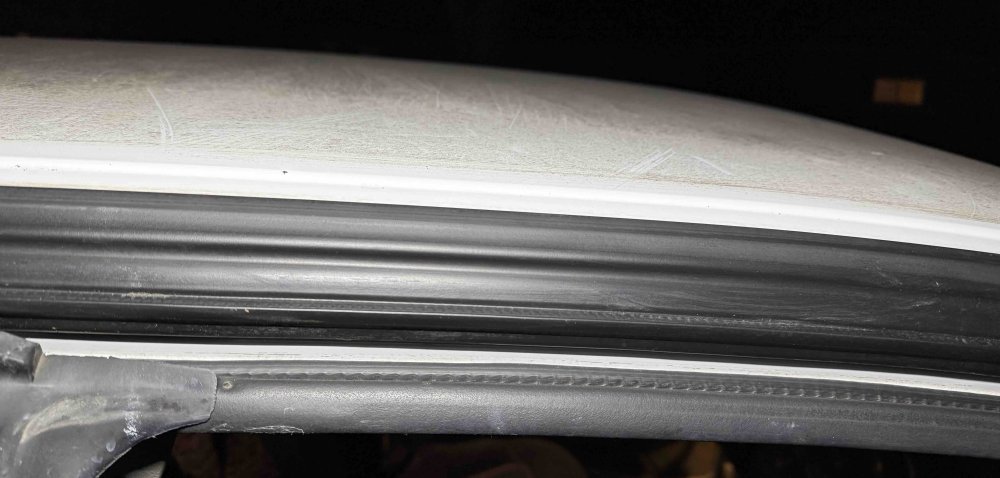

Did some more cleaning. Pulled the outer weatherstripping from the doors. It was still on pretty decent shape but filthy and no much dirt and debris trapped behind it against the body. Soaked it with some super clean, then steam cleaned it. Got about 90% of it. Cleaned up the body where it gets installed then reinstalled the weatherstripping and treated with some gummi fledge. Looked really good now. Hopefully that will help with the water leak at the rear passenger door.

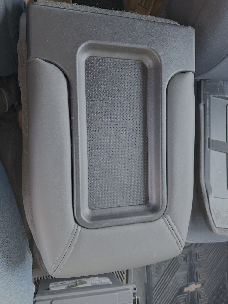

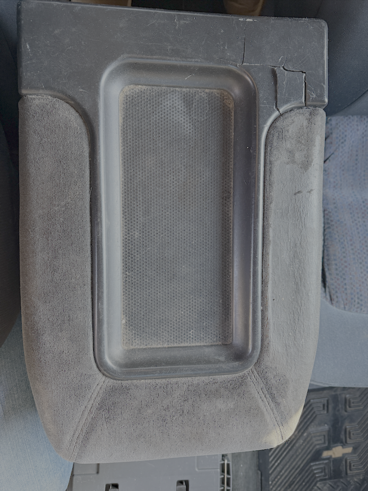

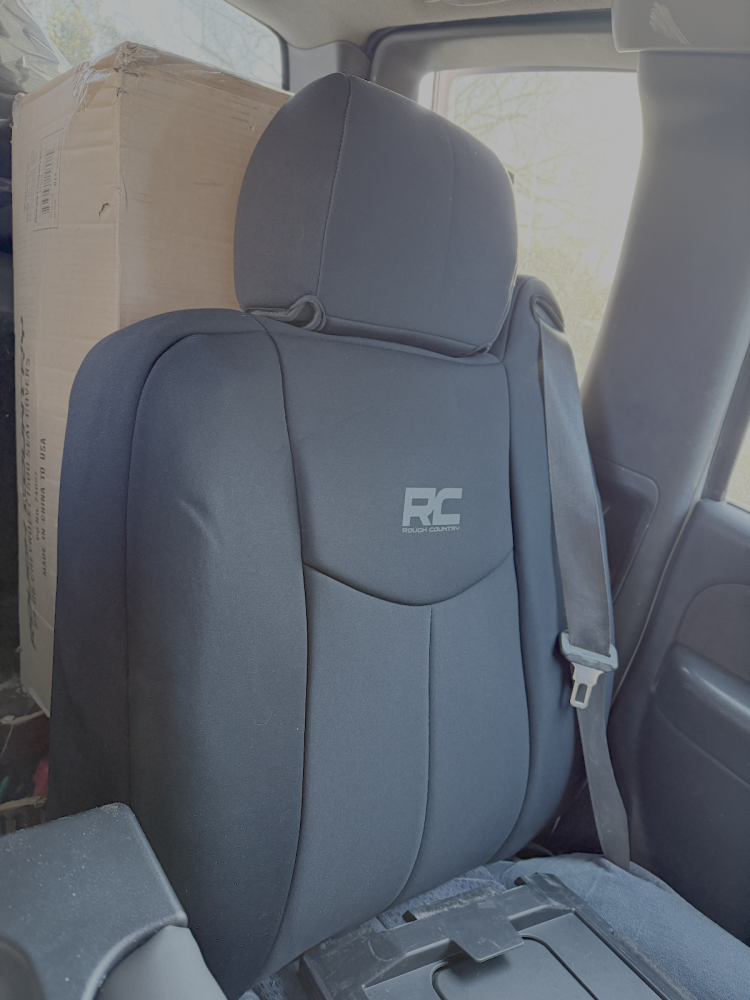

Fixed up the center console lid with a new lid. Cleaned up the windows a bit. Started getting the seat covers on and stream cleaned the door sills really helped them look better. Still need to do the rear seat cover and then need to look at the HVAC controller as I have no blower right now and it’s a bit cold.

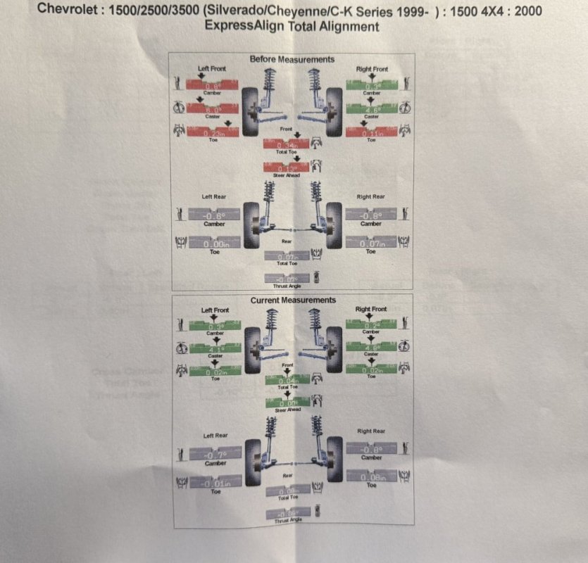

This thing still needs a good pressure wash clean but working through the interior stuff for now little by little. Planning to align it Friday and then work on some more cleaning over the weekend. Then I’ll start driving it daily to make sure everything else is ok.
I’ve got more photos but I can’t get them small enough to post. I’ll try to get more photos up later.

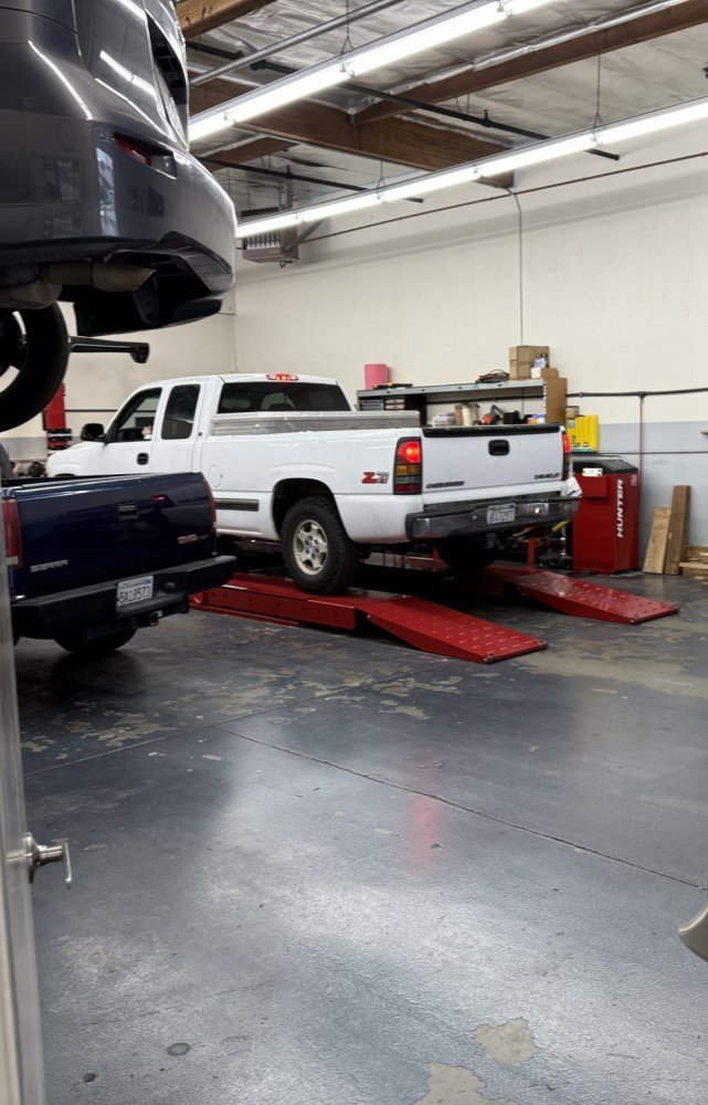

It's awesome you got a shop to do the alignment with the gearbox slop. around here most all the shops won't do the alignment without replacing it. I had tried with mine once and they flat out refused. charged me $40 to check it and told me it would cost me over a grand, said I could put the $40 I paid toward it but wouldn't do the alignment until fixed. turned around and went to another shop who was an old school guy. he told me that's how those franchise shops get you. he did the alignment and only cost me $80.
Yeah the guy I use here locally is really good. Not cheap but he’s been able to align anything I bring him perfectly. As long as the tie rods and pitman/idler aren't wasted. If the box has a little slop he'll do a pretty good job of getting it dead center. it's a small family run business.
