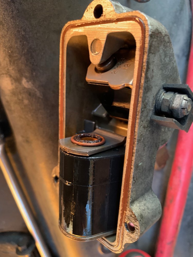

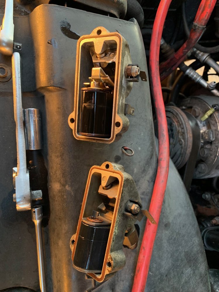

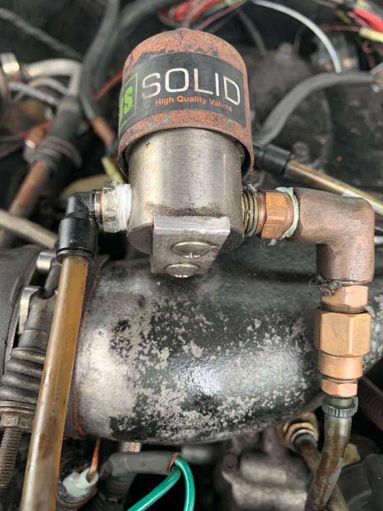

when I pulled the top off the IP on this 93 truck I found that someone has taken the fuel shutoff solenoid lever and broken it off! see photos below. now that I installed the top cover from the 6.2 engine and connected the right wires to the solenoid, when I turn off the key the engine immediately shuts off where as before with the solenoid that was remotely mounted with the return lines is was a slow shutdown and sometimes did what I call "dieseling" like a gasser does when hot or out of time!
IP top from the 93 truck
Here they are together first one is off the 6.2 engine I have.
The remote solenoid the PO had inline with the return lines, now has been removed completly
