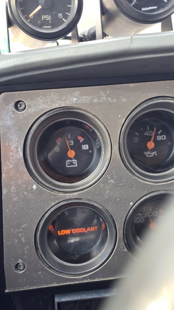

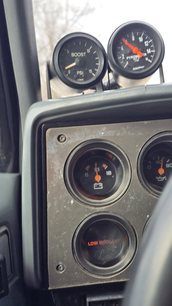

Drove for 40 minutes or so, alternator was up to 13.5 on the interstate, then I turned on the headlights, heating, and then it went down to 12.5.
At idle id be at 12.5, then it dipped to just barely above the red zone, then jumped back to 13(ish).

Left it alone for an hour or so, didnt plug it in (32°F here) and it actually fired up, didnt hesitate or show signs of struggle.
Still, its been that voltage at idle (granted heating is on blast), second pic is voltage while on the interstate (headlights and heating on).
Should I test the alternator and batteries tomorrow? Or am I just overthinking it?20260203_152839.jpg20260203_131753.jpg
