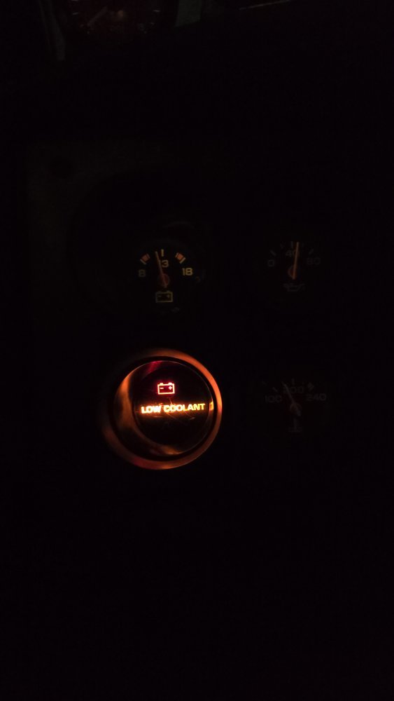

Means the alternator isn't charging. check the voltage with a digital
This is so wack and weird, it does that at start up (starts up fine btw, no hesitation or anything). But when I barely put it in drive it goes away.
Voltage goes up whem driving, dips a bit when at idle.
Guages are dim, ugh
Thoughts? Perhaps the diaob also went bad, do they sell those?
would have to get a meter on the battery to verify, but if voltage is good there, need to check voltage in the cab. there might be a loose connection.
