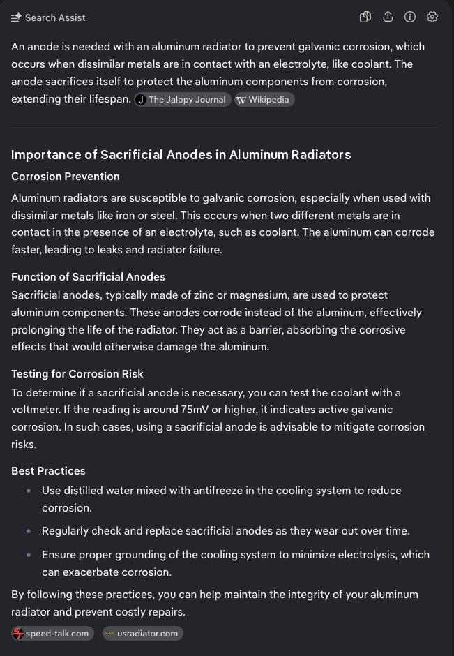

Yup dye is an option and is cheap. it should be available at most auto parts houses. Just read the label and make sure it's compatible with the coolant your using. in you pic I noticed that it's reddish orange in color. hope it's not the dreaded Dexcool! that stuff can get corrosive and eat aluminum.
Oh that also reminds me that on aluminum radiators, you need to have an annode installed too. you could be electrically destroying your radiator!
I forget the term it's called, but I know @Will L. has mentioned it before.
galvanic corrosion, that is what it's called. I googled "why is an anode needed with aluminum radiator" and got a slew of sites talking about it and how it helps identify problems in a cooling system.
duck duck go search AI gave me this tidbit.
