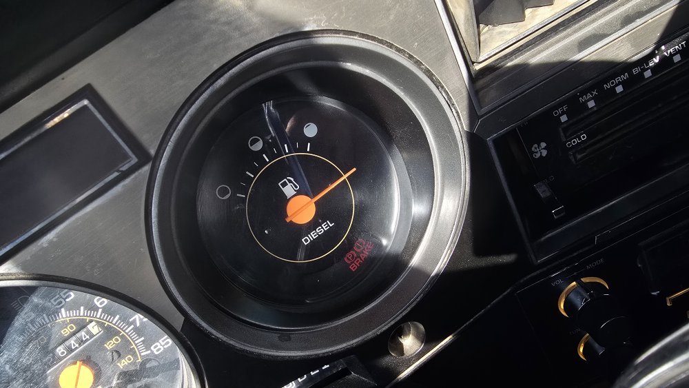

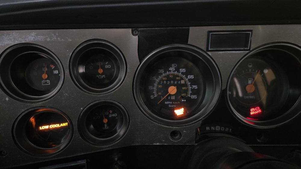

Not even 10 minutes later and the dashboard lights including my radio shut off, though the guages themselves work (Thank God), only the items that are illuminated in the photo is what currently has light.
What the frick happened?? What can I do?? Its running fine currently, guagrs work just no light.
I am genuinely so upset this happened, got two squarebody bros in Minneapolis, gonna peep it tomorrow, cant believe this happened (guage lights are still off, guages itself still work though)
Have you checked the switch that dims the interior lights to see if the lights are turned down?
Its still like that today, literally everything works minus the radio and guage lights, the damn dome light even works.

It was the damn tail light fuse that causes all this, its fixed now

It seemed to me from my past years in the square body trucks I had that it could be the possibility of two fuses.
I could remember that there is a gauge lamp fuse but I could not remember which fuse the other one was.
Yup, tail lamp fuse.
something is drawing too much on that circuit. check your tail light bulbs. could be the socket contacts and the little nubs on the bulbs. simple fix is to replace the bulbs. that or it's getting moisture in the socket and if it has been snowing where you got salt up in there too, that will carry current to the ground and short out.
