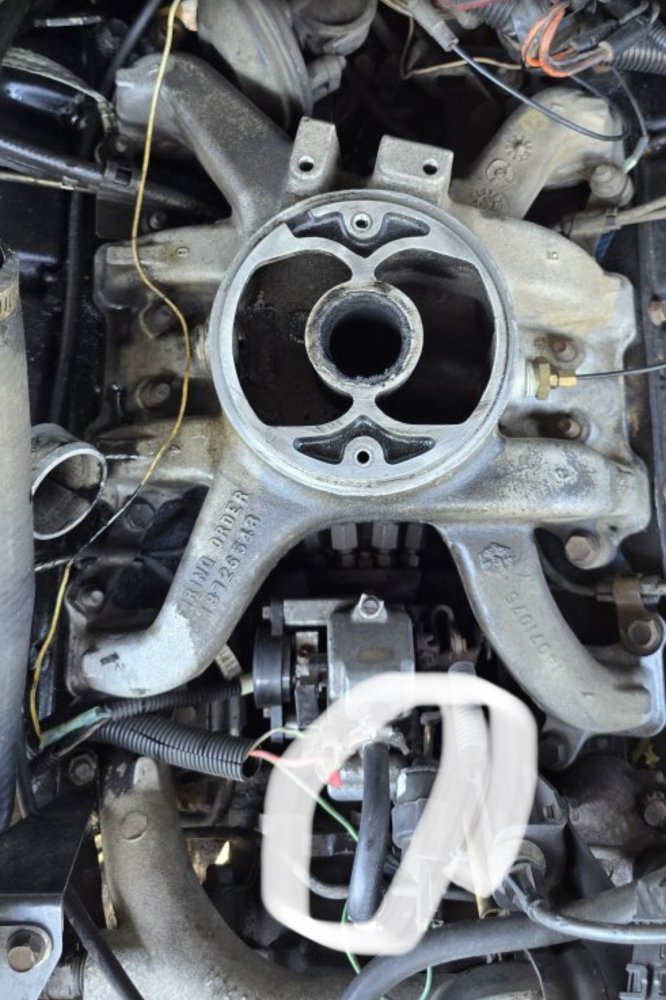

Is that oil leaking from inbetween upper and lower intake manifolds?
First I am addressing that .
Wish I saw this before you reinstalled everything.

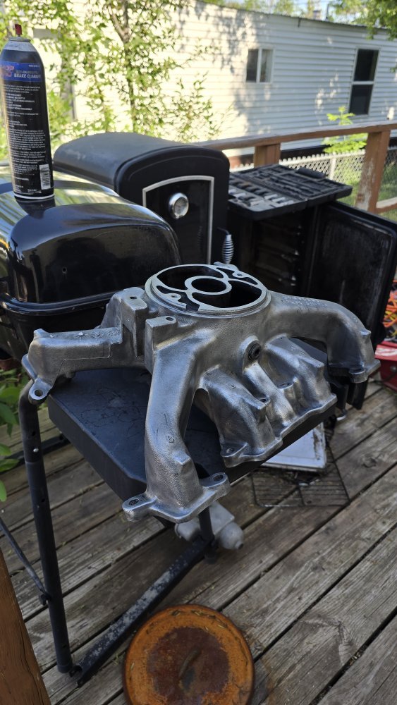

Suggestions for it taken apart is:
Plug intake ports as good as possible then Clean it all.
Get intake manifold gaskets with block off plates for egr and if not available do the soda can trick for that.
Consider a steel 5/16” pipe that extends the inlet for the ip fuel supply to the rear of the intake manifold. From there connect a T fitting and put the king nipple in the end of it. Connect new fuel hose on it from there to the fuel filter. The rubber fuel line should all be SAE30R9 to withstand the rubbing and the alcohols that are stuffed into our diesel fuel. The third port of the T should be 1/8” npt for a fuel pressure sending unit and a gauge mounted in the dash to see when driving. If you can’t install the gauge & sending unit at the moment, at least add the pipe & T with an 1/8” plug for now.
Having everything cleaned should help id the exact location of the leak(s).
If it is engine oil - addressing stopping the oil from getting into the intake manifold is next to address.
Cheapest is venting to atmosphere like diesels did in the 1970s and before. But this kills the earth, or at least spotted tree whales or something like that according to the epa and possibly your local policing agencies. Venting to atmosphere stops the oil from getting into the intake manifold. It does not stop the visible smoking, often it makes it more noticeable just at the drip hose not the exhaust pipe. And the oil consumption stays the same.
The new amount of oil burning smoke- might indicate bad valve guide seals but that won’t put oil into the intake manifold. That is more a sign of worn or damaged rings and or cylinder walls.

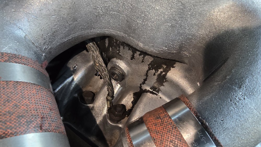

Second thing I am addressing is leaking fuel - that’s what the valley looks like in the last video you posted. You are going to have to see the actual spot it comes from. Inspection mirror sometimes gets it but best is a boroscope.

1. While we didnt add a pipe, we did add new rubber lines from Oriellys, the rubber pipes were what seemed the most wet
2. The turbo manifold was a tad loose after we took it for a test drive, we since then tightened down the nuts and it hasn't moved since, we're going to look it lover tomorrow as we want to make sure that its going anywhere
Also, venting to atmosphere?
3. Oh great, that sounds like a fun thing to do (regarding the cylinders)
4. Will definitely get a mirror or something, we tried to put our phones down there, didnt work out too well, were gonna try again tomorrow when the motor is cooler.
