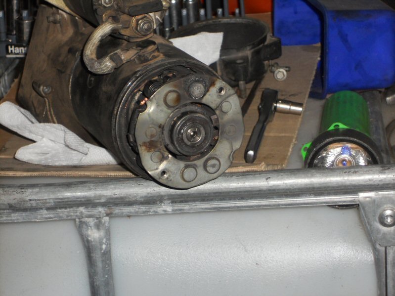

Powermaster starter vs. sticking injectors. Hear how much faster it's spinning over than the OEM starter on the yellow truck?
Slow spinning starter with burned brush ground: (I used lots of glow plug time till the Powermaster starter arrived.)
