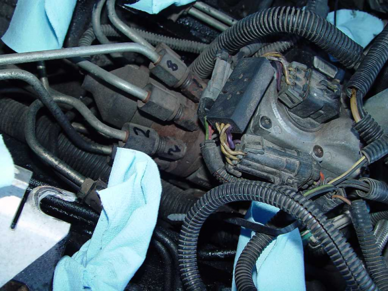

OP = optic sensor. the connector you posted a photo of on the IP (injection pump) here is a photo of the noise filter inline on the harness to the OP.

seems as if the leak is from the OP as the fluid is within the connector housing But I will verify it’s not the other thing You mentioned.

just a heads up. if the fuel is coming up from inside the connector where the pins are and not around the o-ring seal at the IP housing, the optic sensor will need replacement. this might require you to pull the IP and send it to a shop as it has to be aligned inside the pump.
It’s hard to tell but it seems like fuel is inside the connector… that must mean the optic sensor needs replacing too..
do you have any advice on how to verify if it is indeed coming from the Op or just the failed O-ring?
Clean it up and start her and see what happens I guess is the obvious?

Yep clean everything up with some brake cleaner to remove all the diesel residue. use the compresser blow gun to dry it all up afterwards. gather what you need to shut it down by means of choking off the intake incase of runnaway. crank her up and watch closely. that area of the IP shouldn't have any pressure on it other than what your lift pump near the fuel tank can apply to it. so you can energize the lift pump without cranking and watch for a leak to appear.
what year was you rig again? if it lift pump isn't wired to run with the key on I can tell you how to manually energize it and not have the engine running.

iirc when unplugging the OS connector while running it will abruptly kill the engine but will start up again with a longer cranking time leaving it unplugged as long as the CPS (crank position sensor) is operational. KyleH can possibly do this checking for the leak so that he can watch and see if the fuel is pushing through from inside the OS connector on the IP.
