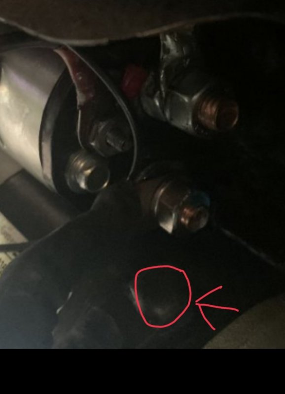

Test voltages and then you may be bench testing the starter. It's possible it's locked up for any weird reason that you have not found yet.
close the two thick bolts on the solenoid relay. starter should rotate but not start engine.

from one of the thick bolts on the starter solenoid. the wire leaves the starter motor. usually a braided copper bus

The starter may be bent somewhere?
