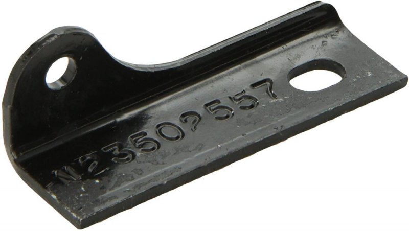

Gotcha, i got the bracket for starter today and new glow plugs nowTo me that would indicate that the glow plugs system isn't working right. Should be indications of them glowing red hot almost yellow/white

Fair enough, i have the new flex plate amd everything is ready to go, just waiting for the rain to slow down so i can hop back under the truckThat absence of starter rear bracket will cause something like this.
At least it did not cause the starter to drop and take a chunk of the engine with it and then you have to fix the starter bolt holes.

Where abouts are you guys located?With the starter system damage I suggest new starter bolts from GM.
