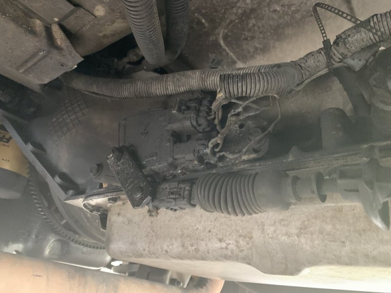

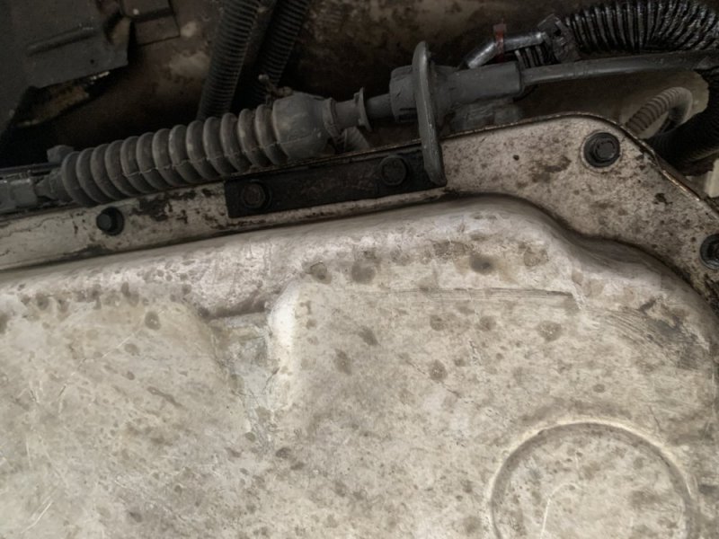

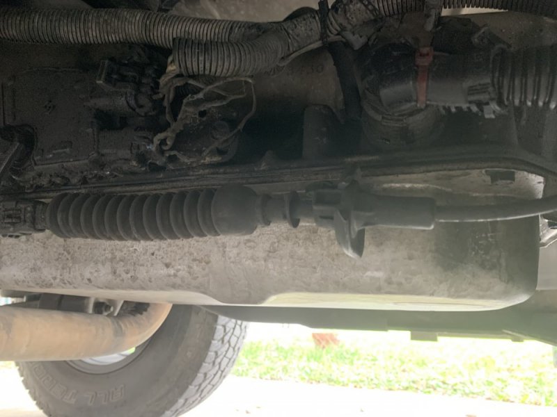

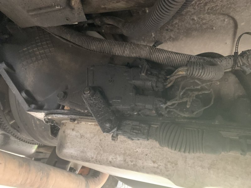

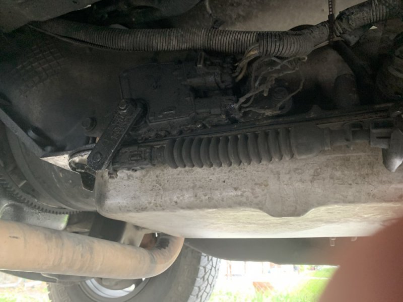

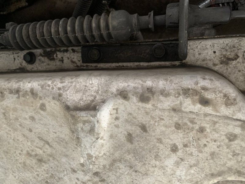

I took some photos on mine in 1st and in park. The first two are in 1st. Others are in park and a couple of the cable mount bracket position on the pan
mine when I pull the shifter down from 2nd to 1st the shifter doesn’t have a slot so to speak like all the other gears do. If that helps with anything
