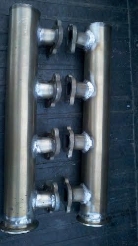

I'm being plagued with header leaks on my custom stainless headers on my P-400 upgrade in my Motorhome.
Originally we used stock exhaust gaskets, but the bolts would loosen some would even back out far enough to fall out. We talked to Peninsular to see what they recommended and they said to use high temp RTV and regular header bolts. We did that, but used locking header bolts. Well that lasted about 500 miles before blowing out on at least 3 cylinders.
Next we will check the headers for straightness and try to figure something out.
Thoughts?
Here's a pic of the headers
Thoughts?
