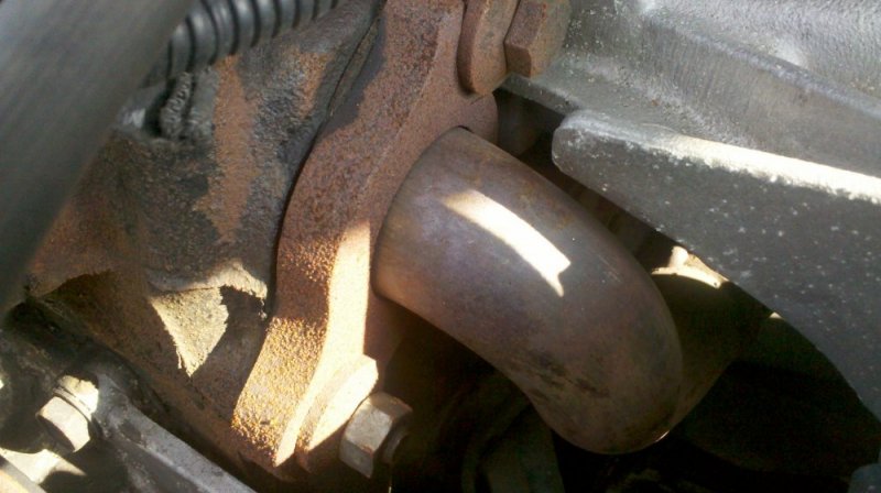

Now THAT'S a flange!I was looking under the hood of my Jeep today and saw this heavy duty flange on the exhaust manifold.

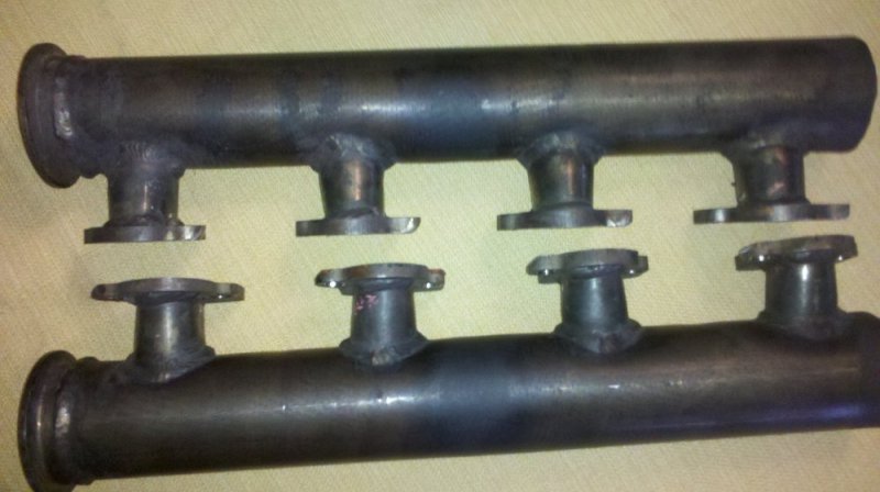

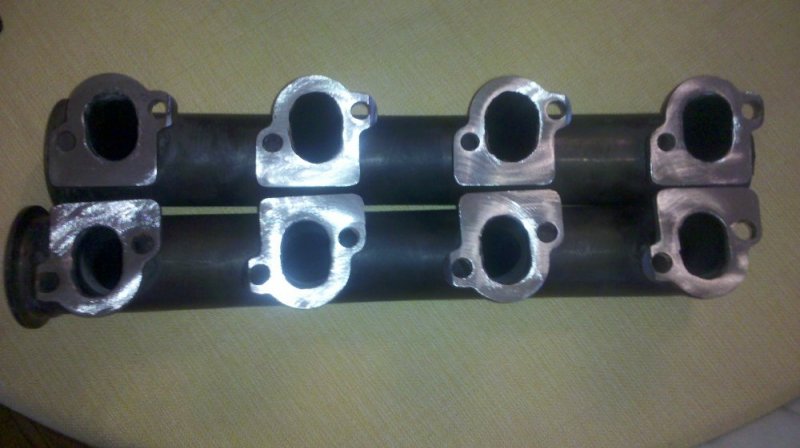

Well, here's what I got from Peninsular today.
I'm not sure if I understand what they are going to do.
"Jody, we believe we have found the problem. Over the years the cylinder heads have been produce by different foundries and each time there are slight changes in casting and machining. Why I wanted the picture was to see which heads you have. Basically what is going on is the area that is machined for the exhaust manifold to seal too is smaller and the flange of the exhaust manifold is not quite sealing because of interference with parts of the casting mold seam (where the two halves of the mold come together). So when you used silicon or a gasket it would seal at first and then blow out as the bolts worked loose from the heating and cooling cycles. The fab shop is going to make sure that you have the clearance that you need.
Thanks,
Mitch"
