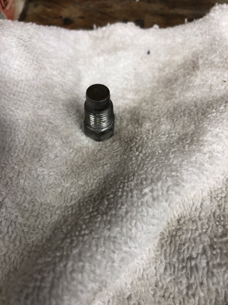

Is this an anode plug ?
This is what is screwed in for block drain plugs.
I had both plugs out of the block and forgot this was the style of plugs that was in the drain holes.
Also, on the top of the coolant pump, where the lower radiator hose attaches on, there is a nice flat spot that would be an excellent place to drill through, tap to 1/8” NPT and screw in another anode plug.
That might be what's left of an anode.
Something I have learned with cast aluminum in cooling systems is it corrodes no matter what you do! what really gets it is when the coolant goes sour (PH too high or low) 99% of folks never check this on gassers nor do they know they need to. when this happens the coolant turns very corrosive. at work we had a truck blow a head gasket (was an affiliate truck we didn't service at our place) the truck was driven into the shop. I could see where it blew since the side of the block was wet where coolant was slowly leaking from the head gasket out. the engine still ran great only the driver called in over "disappearing coolant" before we started tearing apart the engine, we took it out to the wash bay and power washed everything as normal. These trucks were Freightliners Columbia cabs with Mercedes inline 6's the blocks were painted silver from the factory. that coolant ate through the engine enamel where everywhere the coolant touched was bare clean cast iron!
When you fill the coolant back up, use distilled water unless you choose to go with the 50/50 premix stuff. Tap water can attribute to these issues over time.
