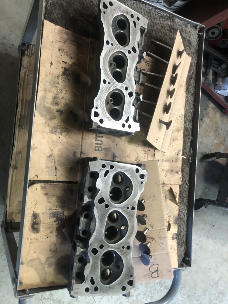

Head or head gasket ?
Heads are at the block and heads shop.
He looked over the heads and said these heads dont crack in such a way to cause compression to pass to the cooling system.
He did mention that the valve seats are in pretty rough condition but said He would give them a once over so they’ll be better than they now are.
Said it’ll be about three or four days before they are done.
$100.00 seems reasonable to Me.

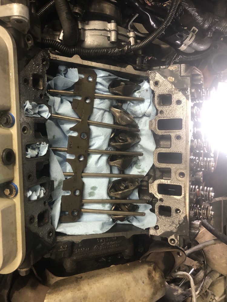

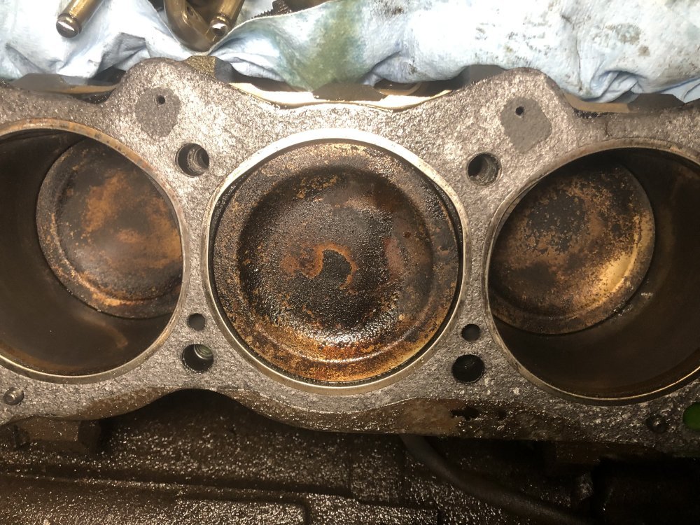

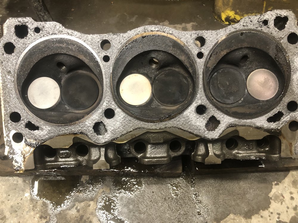

Clearly you have a problem in the rear head area or block. Pictures you posted do not help. You need the entire rear head gasket examined both sides. If you don't see where coolant or carbon was tracking, yes, look for cracks. Including cracks past the valve seat into the runners on the head. Possible you cracked a cylinder too. Just because the generally don't crack doesn't mean "never". After all weak antifreeze will crack anything!
I would put the rear head back on the front of the engine in case they miss a crack. If the bubbles follow the head otherwise it's the block.
These heads are cast iron as well as the block.
The head gaskets was some kind of a silver graphite sort of stuff. They really ripped apart when the heads were rocked free.
I did take them to an independent shop where He deals with such as this more often then I do.
He pointed out one spot where He thought it looked like the gasket had been leaking.
