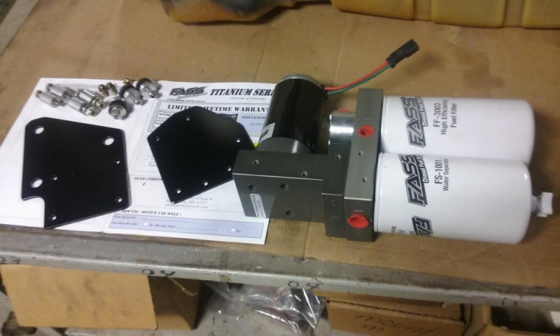

The motor is .020 over with Mahle pistons, Hamilton cams head, Hamilton 188/220 cam, 88/66 Compound, Fire Ringed head, 14mm Studs top and bottom, Gorilla Girdle, JGS BV system, Farrel Diesel 13mm pump, .105 injector lines. The Fass pump was way better than the Raptor and we made rubber mounts to isolate it from vibration, something that anyone mounting pumps should do.

We haven't had problems with the FASS unit yet, but in talking with them they recommended deleting the supplied plug and soldering the wire connections. Apparently they've had issues with the smallish pins.
