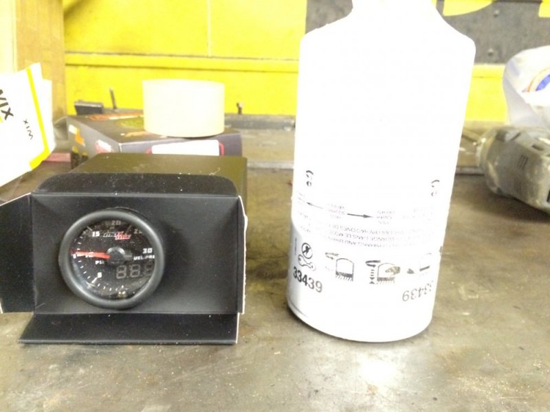

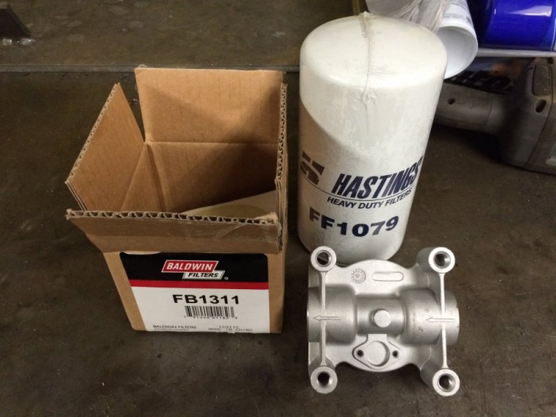

When Leroy giveth, he giveth in spades!!Stickers? WTF, with the plural?
Got some work ahead of you Nate.
