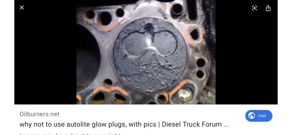

Thanks guys, can you tell if they are self regulating GP,s without pulling them? When they turn on they run about 6to7 seconds then if I turn them on right away they only run for a second. Are they still in danger of swelling because their no marking son them? The motor starts cold w/one GP cycle. I am not opposed to pulling them if they might swell. Thanks.

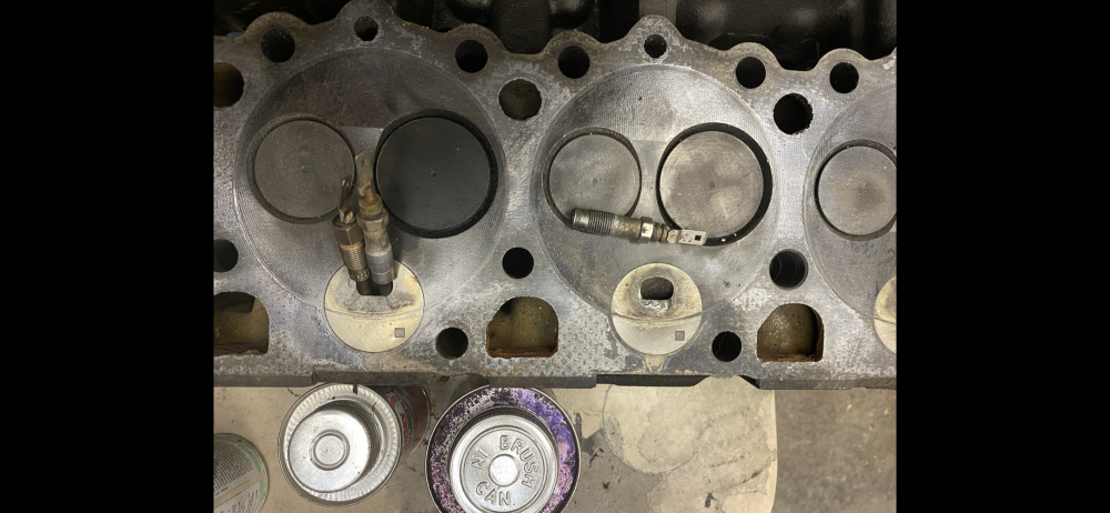

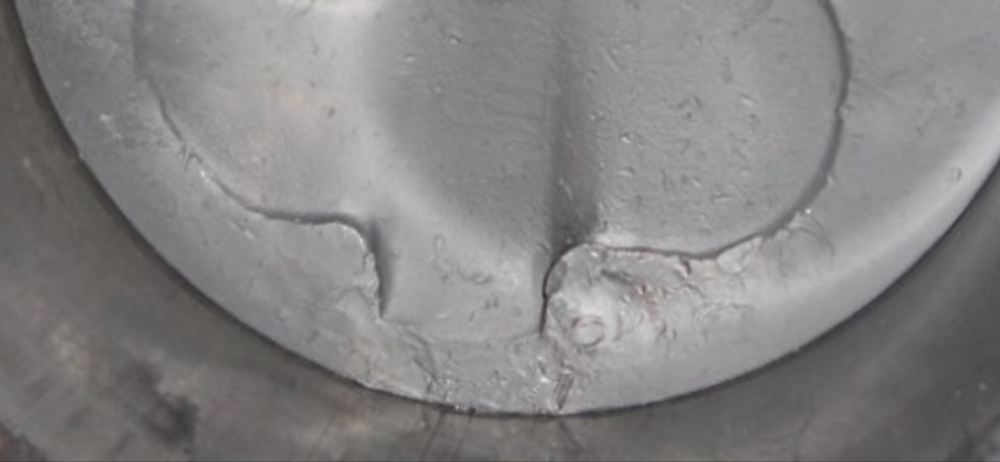

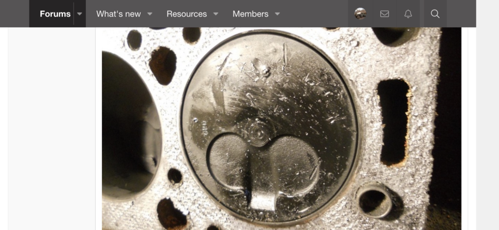

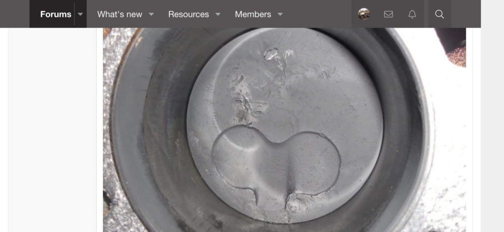

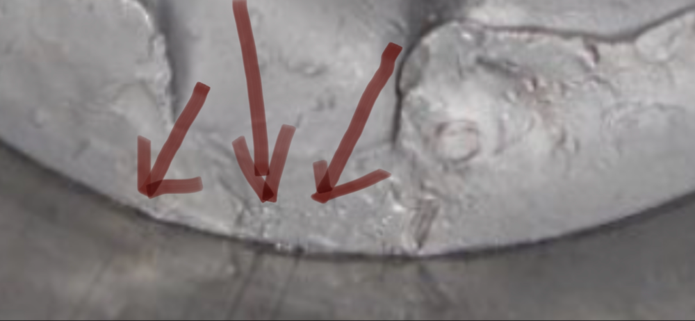

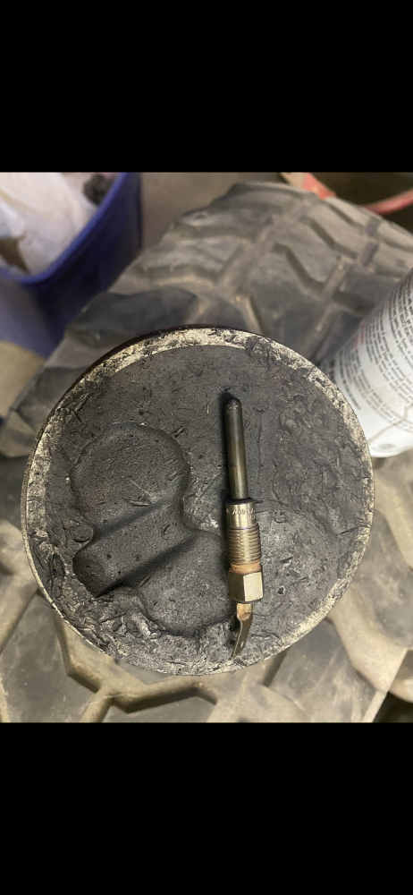

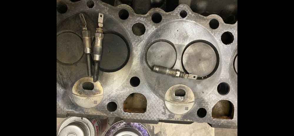

Buy the AC Delco 60G plugs. Attached is a picture as to why you don’t want anything else in there. Quadstar, Leroy Diesel, Twisted Steel Performance (TSP doesn’t sell glows afaik) are all trusted suppliers. If you buy AC Delco anywhere else it NEEDS to be a brick and mortar AUTHORIZED DISTRIBUTOR! Call them to verify what source are legit. The piston out of my optimizer with less than 70,000 miles on it is the one on the tire. Some are pics of similar events. The head with the broken off plug is mine. Nicely destroyed precup. I still never pulled valves but 50-50 chance one is destroyed. I got LUCKY! Zero block damage. The pic with piston in engine is someone elses- I am pointing out where the cylinder wall is scratched and will blow by so now oversized piston is a requirement for his engine.
I’m warning you as strongly as possible: DO NOT EVEN START THE ENGINE AGAIN UNTIL THE 60G PLUGS ARE IN!

I wouldn't delay on the glow plugs.
You've seen the pictures displaying what crap glow plugs can do

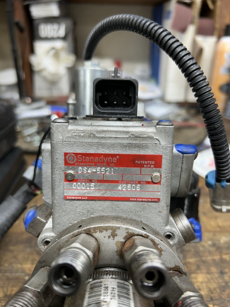

Did you take look at the TSB. It’s very confusing to me. The new pump and engine harness seems to be the original design (as per TSB) and my original pump and engine harness and PDM extension harness are the currant design very confusion. Shouldn’t it be the other way around?
Here’s a pic of my original pump. Notice the white sticker. Was it repaired in 01’ or upgraded?
That is odd. I would only assume the new pump has an aftermarket harness on it of a chinese mfg. or the new pump is a reman that when it came in to them as a core had not been updated. This makes me wonder if updated parts were used in it's rebuild, as older parts before the update are still in circulation and if deemed still usable by the rebuilder, would be installed into the pumps going back out to be sold.
I thought I mentioned in my post that the new pump was a reman. I read some where the reman pumps come w/ red ID plates. Still curious if my original pump was opened up at some point because of the white sticker. I still haven’t heard anything back about the reman pump. I called Huckstorf Diesel about checking the reman pump out just in case QS doesn’t warranty it. And Huckstorf said he could not check the reman pump because it was already on a truck and running. He said the fuel left over in the pump would ruin $500 worth of testing fluid on the tester. But he can check out a reman pump that has never been ran. Boy that was a gut punch. Looks like I might be buying another pump and sending it off to be tested. Or hope I get another reman pump under warranty and still have to have it checked out. Boy this could get expensive. I also may call around to see if anybody will test this reman pump that has already been run. I’m going to call him back and ask how much to rebuild my original pump.
One would think they have ways of draining or flushing a pump so it doesn't contaminate their test fluid. I feel like that was an exaggerated answer for "no we don't test without rebuilding"
Yes the red tag is an indication of a reman. the blue tag on your old one is or was put on when new. GM had many recalls or campaigns where folks would have the dealers replace them with the updated pumps when in for service. your old pump has never been into since it was new and the date was it's build date.
