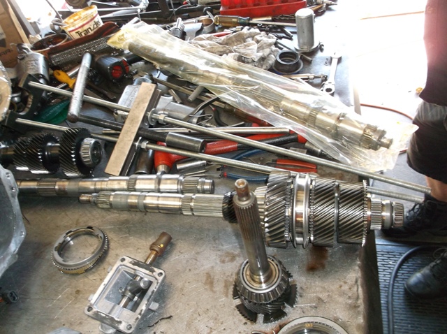

Main shaft did come in today. Thought Id be getting more pictures, only got the one and its still in the plastic bag. The shaft to the left with all the gear still on it is the one getting replaced. You can see how much longer new one is.

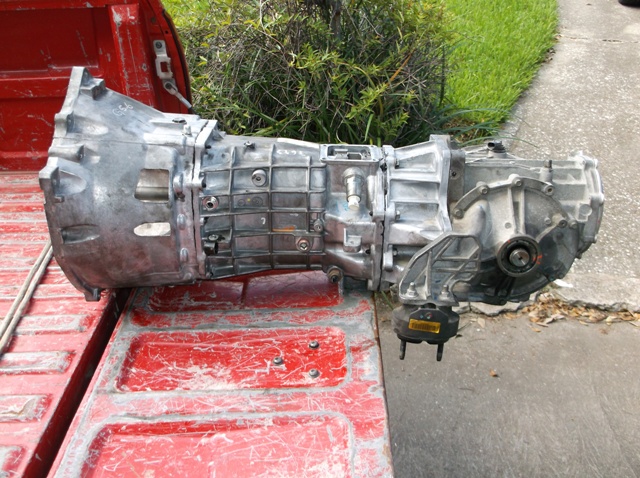

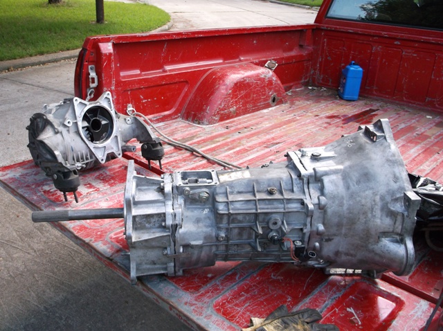

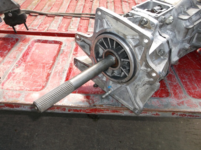

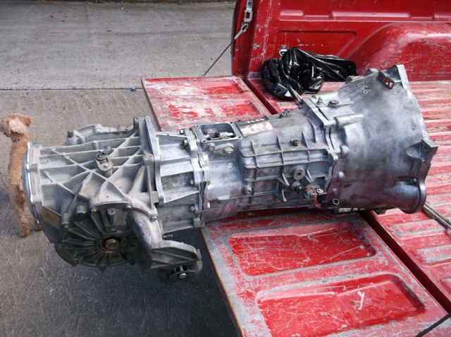

More progress, Got the trans/axle back today. Its a TR6060 from a 2010 Camaro that I had to replace the output shaft from a Corvette TR6060.
This is going to allow for a compact drive train as you can see. The engine bolts directly to trans and trans to diff.
This is where I'll have to fab in a shifter. I wanted to use the stock Camaro peice but it hit the new Corvette tail.
Will be an easy fix though just have to find a shifter or modify mine.
