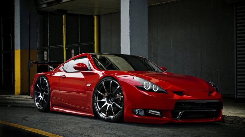

Also, I've been thinking a lot about a donor car and its hard to beat the Fiero for what Im doing, but Im looking real hard at the 350Z cars. If anyone has one or see's a donor/cheap on craigslist or?? let me know.
What the fiero has going for it is its a 1986 car so won't have to be inspected and can get classic insurance for it. Its also pretty easy to fab a rear sub frame to hold engine/suspension and I like the fuel tank position.
The 350Z is much more modern, has a lot of aftermarket support for it. I love the lines of the car, much nicer interior.
My minds eye has me building something very much like a mid engine 350Z.
I stumbled on this picture, its hard to recognize it as a 350Z til you study it for a minute.
Picture this thing with a stretched rear :woot::woot:
