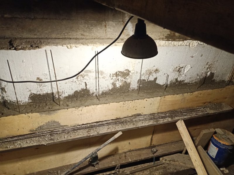

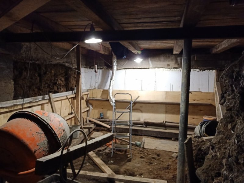

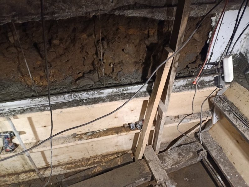

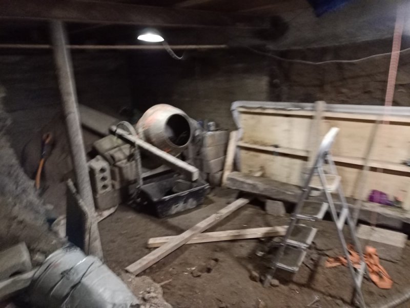

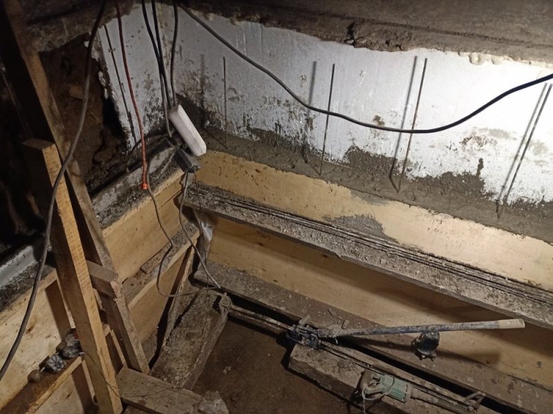

Just saw this thread for the first time, looks good denata. Lots of work though.
I have been involved in several projects of digging out under building and houses to make a basement.
It is okay if there is someone atop to haul up the buckets.
The best one I helped on, the guy has a motorized home made flat belt between two 12 foot long 1X6s. Cant think what they are called. 🤷‍♂️😖😩
Start the electric motor and shovel the dirt onto the belt and out through a hole dug under the house foundation.
He had a lot of people that needed some fill dirt so they would come over and load up and we didnt have to haul off too much.
After the dig He formed up and poured mono slab floor and footimgs right up against the dirt walls. Then formed out from the dirt walls and poured in between the form boards and the dirt walls.
That turned out real nice after it was all finished. He had all kinds of stuff stored down there.

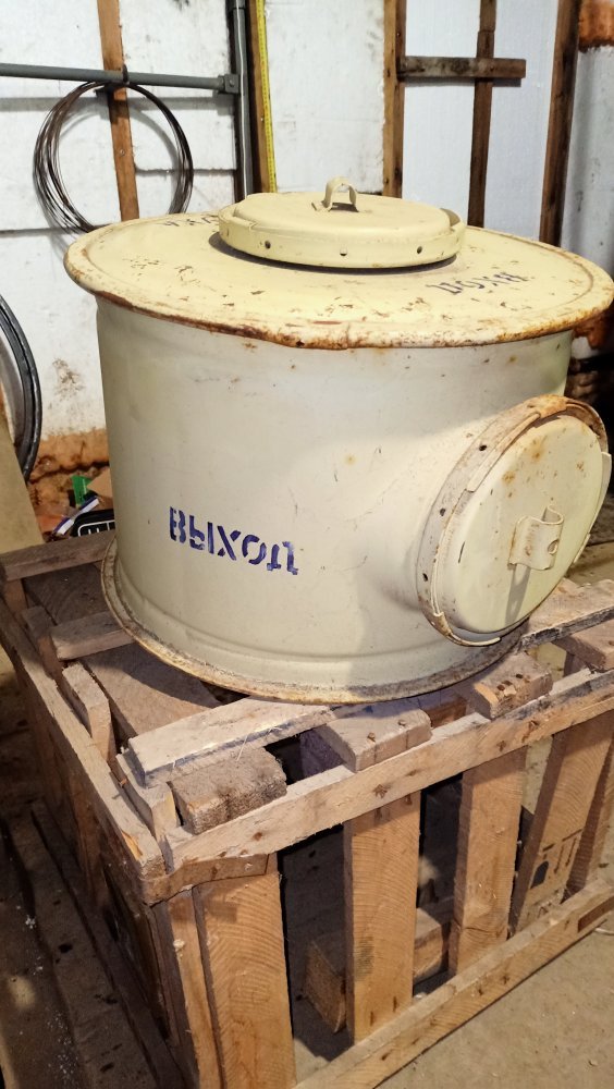

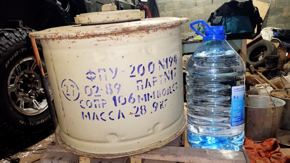

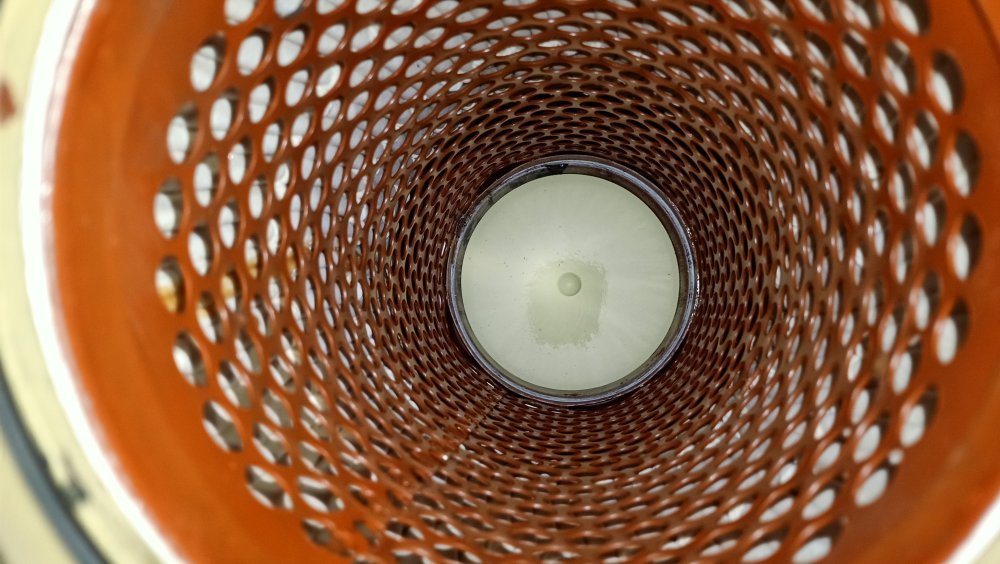

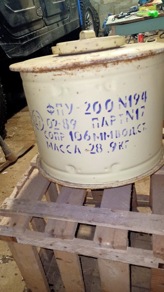

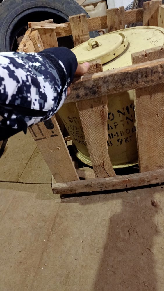

Found at the sale of military stuff. Now I have an absorber filter, the kind used in bomb shelters. It purifies the air from radioactive dust, chemical warfare agents, biological weapons. The resource is 5 years for non-combat use with a purge of 100 cubic meters of air per hour.
Weighs 70 pounds. Made in 1989y.
I'm doing ventilation in the basement. Price $30 I could not pass by.

Does the filter have a shelf life?

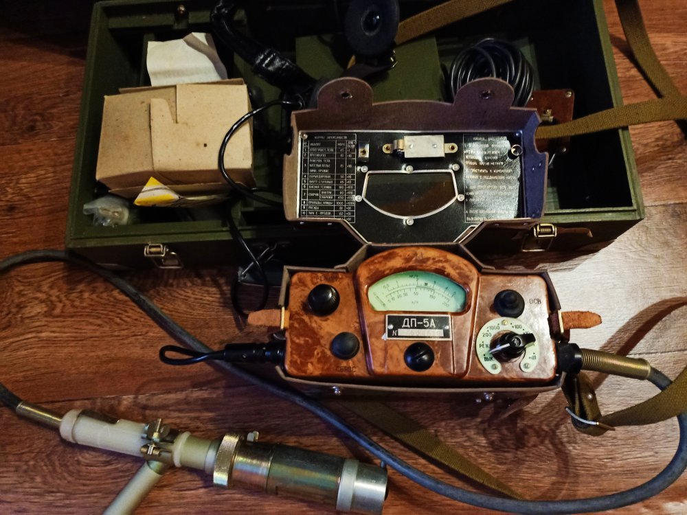

I was going to suggest you obtain one. Because, yeah, you get sent into Ukraine the dosimeter will come in handy in some places. It's been an interesting read (years ago) about a 1986 reactor problem. Not clear on how well the rest of the fallout clean up has come along.

Shelf life 10 years. The filter consists of a dust filter and an activated carbon absorber. I do not think that something will happen to him, in a sealed package. It's like on the packaging of salt in the store, it says "Store 2 years", this salt has been stored in the ground for 200 million years, but in the package you can only 2 years???

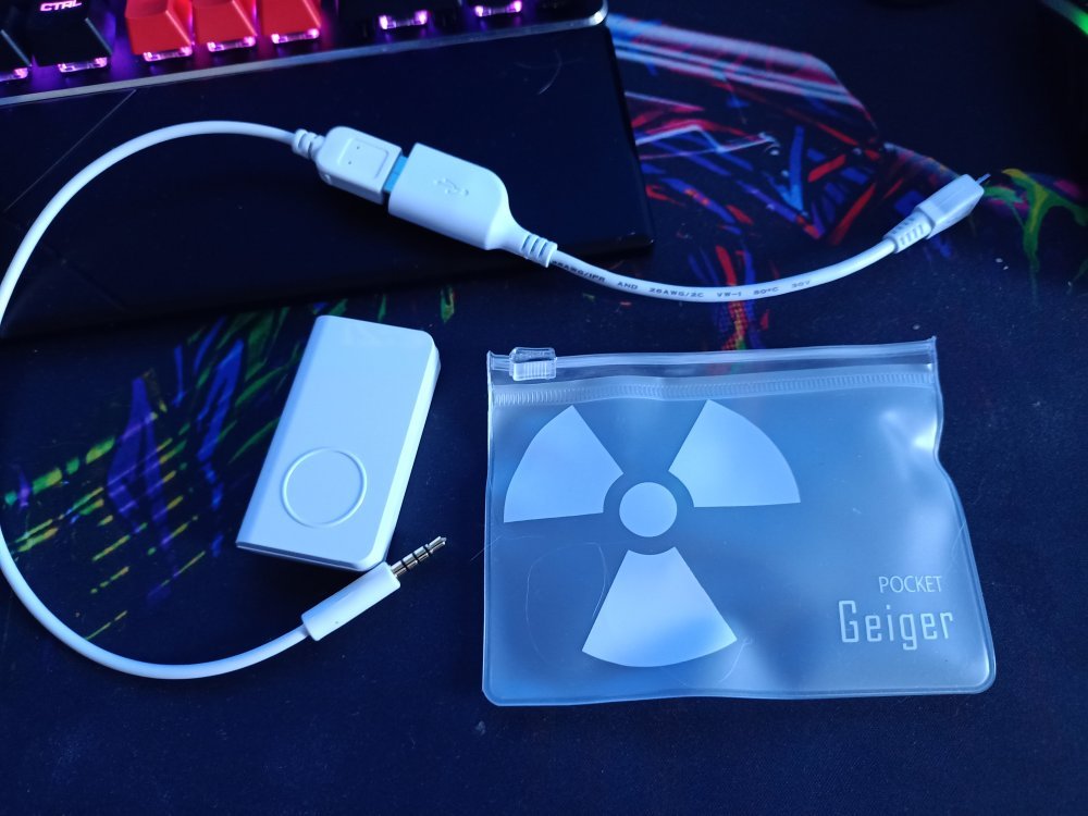

There is a more compact version of the PiN diode dosimeter. connects to a smartphone.
But the best dosimeter is RadiaCode101, it works like a spectrometer and determines which radioactive element emits. The sensitive element is a scintillation crystal paired with an avalanche diode. It has a GPS receiver, and writes a log of coordinates and radioactivity.
