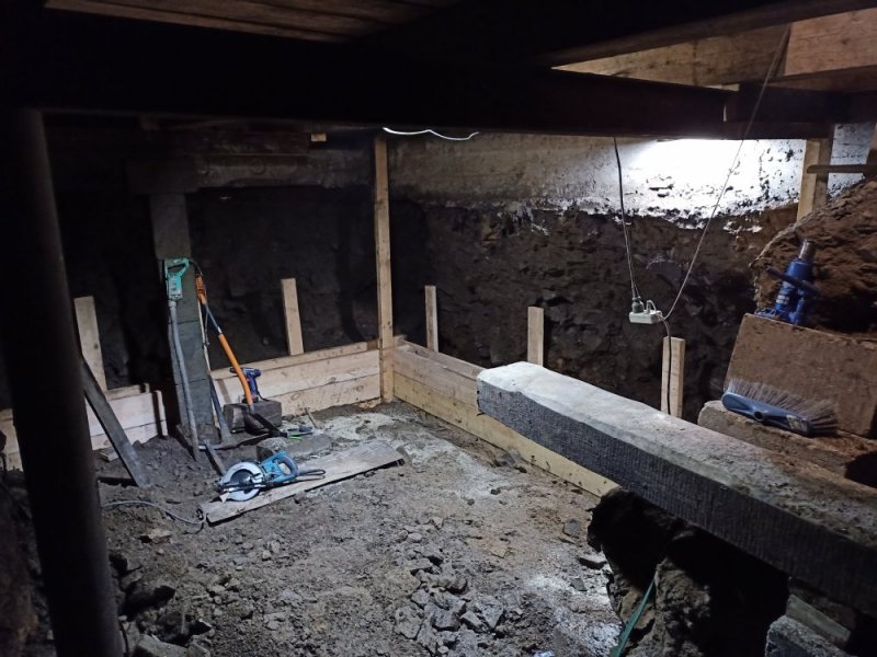

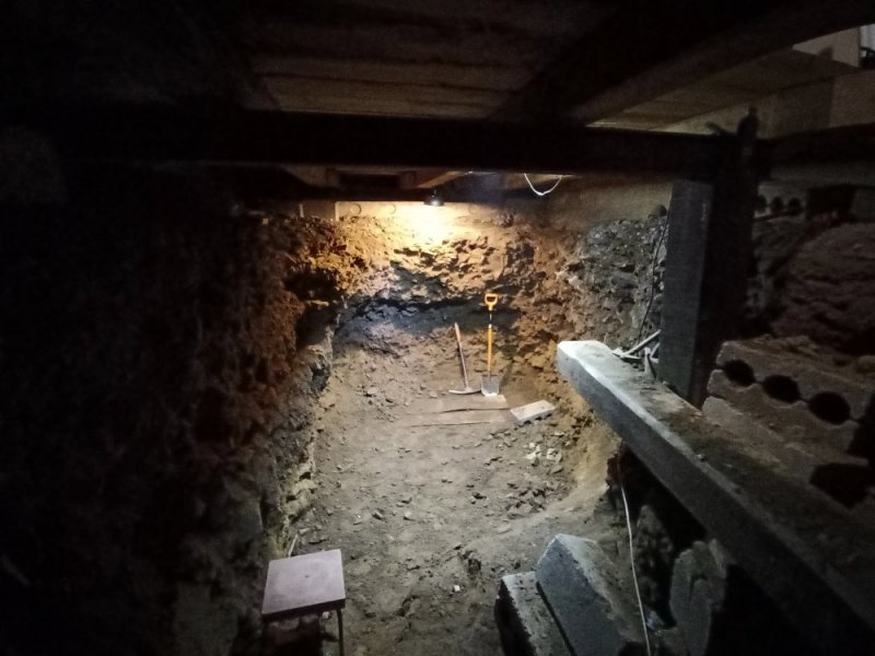

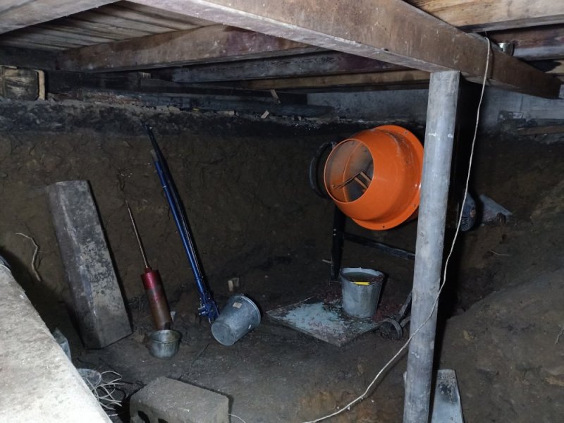

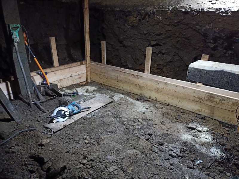

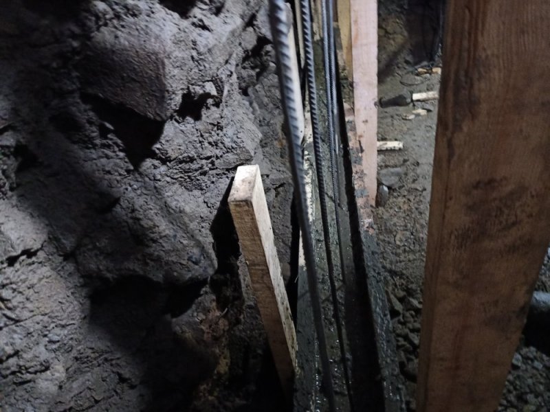

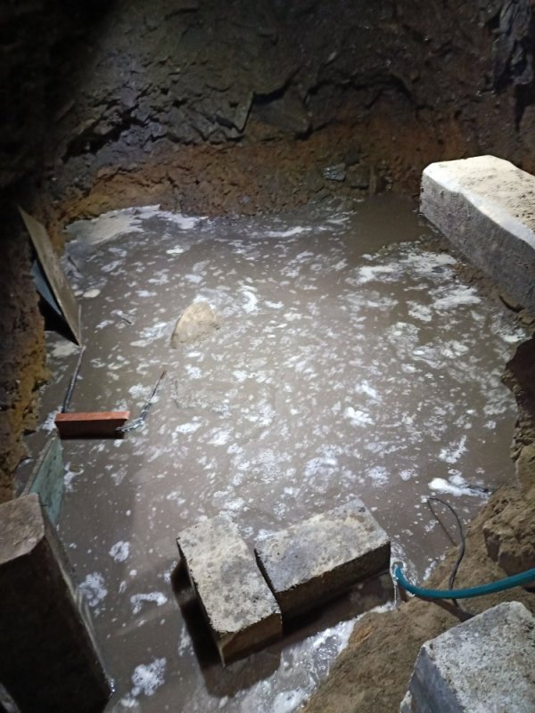

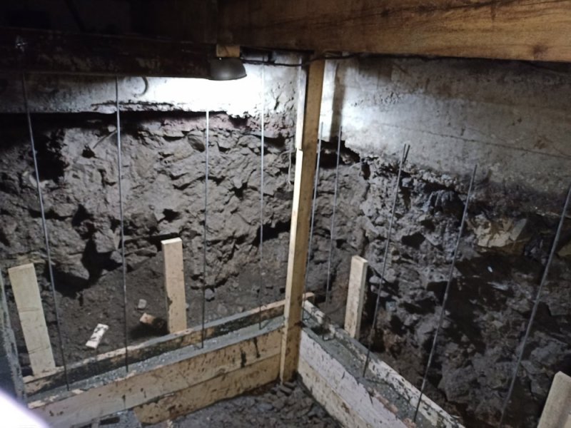

Planned to concrete with a water-repellent additive in concrete. I completed the digging of the basement by 60-70%. When the flood stops. I will clear the landslides, build the formwork. and I will fill the walls with concrete in parts.

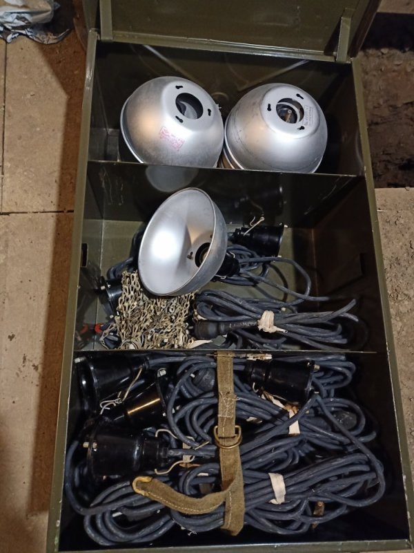

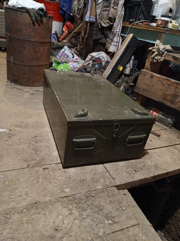

In mil.surp. store - sometimes you can buy useful goods for a penny.
For 20 brand new lamp's and a great iron box, I gave $40

Price of lumber over here, I think that just one form board on the inside of the room then pouring concrete to the dirt wall would be cheaper.
I was told a 4’X8’ sheet of OSB particle board is now over $80.00 american money. IIRC, they used to be about $15.00 but dont quote me on that.
This was planned, the walls to collapse as a result of the flood. and in order to fill them, you will have to fill in a lot of concrete. so I will make a concrete wall and then throw away the earth that collapsed. I buy boards at $ 200 per cubic meter - 50 boards14f 2x4inch (50x100mm). OSB ½ 4x8 costs $ 20.
Rebar $ 1 per 1 kg.(~2lbs).
Cement M500 50 kg (110 lb) costs $ 9.
1 cubic meter of concrete costs $ 100, + delivery by a mixer $ 40
