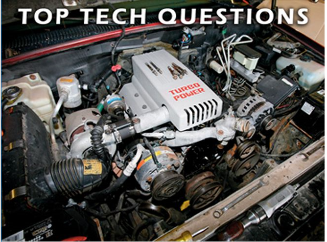

My truck is sitting in a "winter cabin" away from the evils of salt, but if I remember correctly, There's an ABS module over there on my fender-well. Will the filter still fit in that area with this? I really can't remember. I found a picture online - not my engine bay, but mine is set up like this. Where can the bracket go that it won't be in the way of something else?
That is where I mounted my bypass filters on the 98 and one other. I made them so you could remove the whole ball of wax to change the filter easily with minimal mess

......a picture online - not my engine bay, but mine is set up like this. Where can the bracket go that it won't be in the way of something else?
what you CAN do: get a washer bottle from a later model that mounts under the battery. all the room you need will be opened up. i did that. might have to bend the bracket some.
Can you post a further away picture? I'm still not figuring out erxactly where you have it mounted
i can get one in the daylight.
here they are:
here's the reservoir. be sure to get mounts, harness, pump and a good lid with water level.
there's room for GP override, spin on filter, FFM and all the wiring, hoses, gauges, etc. i will clean it up when the bugs are worked out.
spin on has the same type of bracket: stainless, bent in a vise with a BFH, stainless bolts mounted to wheel well. stainless is hard to drill so i use a punch then grind off the surface. i've wasted so many drill bits trying to put a hole in the stuff but i love it for it's durability.
