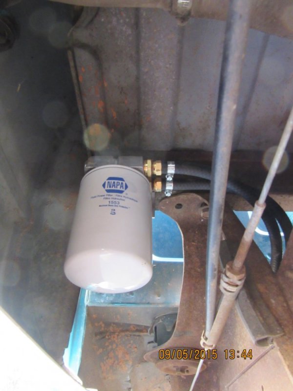

This is what I just did on Sat. The filter base I used was this: http://www.summitracing.com/parts/trd-1045/overview/
Do not see were the one you suggest would not work. I liked Leroys kit as it was inclusive however I could never get the filter to stop seeping. The oring on the supplied filter in the kit was in the far out board position. This filter has the oring in the about an 1/8+ or so from the outside edge that seemed to seat better on the base. Only time will tell.

Chevypoor, did that base come with those fittings, or did you have to round those up on your own? I'm curious - why do both your lines go forward from the filter position? Seems like one would go toward the rear.
No, the base did not come with those fittings. There are 1/2 NPT to 3/8 NPT bushings with a 3/8 NPT to 3/8 hose barb fitting. Used fuel injection clamps instead of worm drive clamps for added peace of mind. Also used a fuel resistant rtv on all the threads prior to assembly. The filter base has one inlet and one outlet per side. First removed the factory LP. Then installed Leroys fittings on each side of were the lift pump was (the 3/8 supply line). Came off from the inlet side were the LP use to be to the in port on fuel filter base (ffb). Then from the out side of the ffb ran to inlet side of the Walbro. Then ran from the out side of the Walbro to the other side of the fuel line were the LP used to be connecting to Leroys other fitting. Since the ffb is mounted rearward of the LP location one fuel line is running back to supply the ffb and the other is running forward to feed the Walbro.
