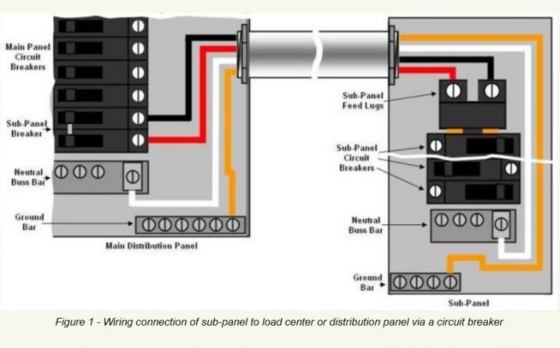

Bootlegged, power stolen from another source. Like an end around. Stealing the power from the other panel, so in essence you would have 2 main panels. But you would need to have 2 main breakers. This is the way it should be wired up.
I should have said before, don't label up the panels that way until you verify that is what's happening. Really need to get the dead fronts off and take some pics. Going to bed to trace the supply wires feeding each panel to make sure of its source.
To clarify RI Chevy's bootleg comment: the picture he posted is how it is supposed to be done. "Bootlegged" is incorrect or stolen power and should never be done.

I agree. I should have been a little more specific. That picture is the correct way to wire a subpanel.
Get the panel fronts off and let"s see inside. I suspect you have one main panel and a subpanel with a 2 pole 50 or 2 pole 60 breaker fed off the main panel. It can't be HOT all the time.
