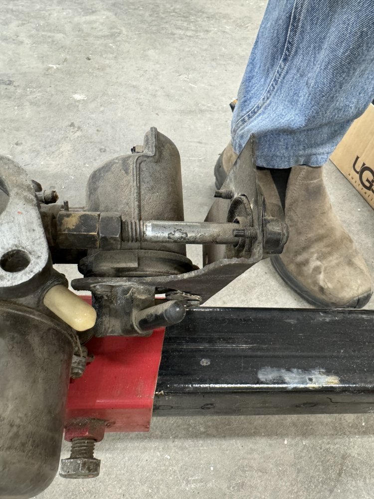

I had to take another look at the first picture. I thought that pin was more visible but You have to take a second look to see it.
Drove through that brass nut, to the left side of the brass nut. It is visible but just have to take an upclose looksee.
Thats what kept the brass nut connected to the throttle shaft.

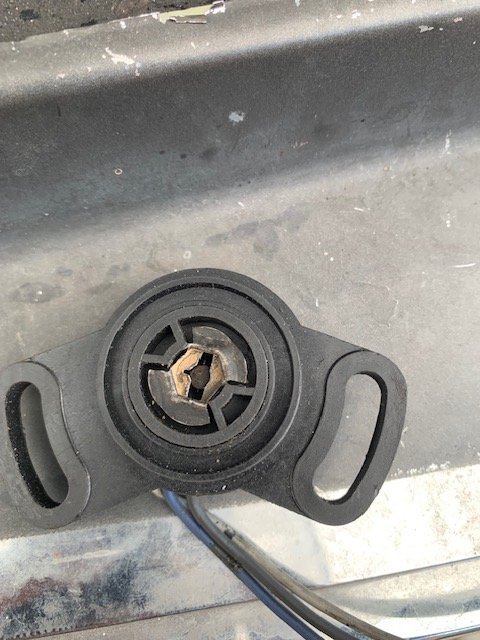

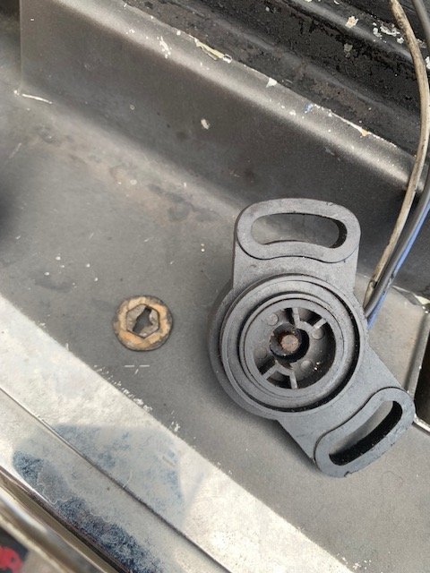

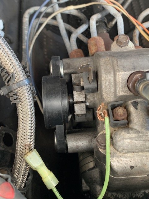

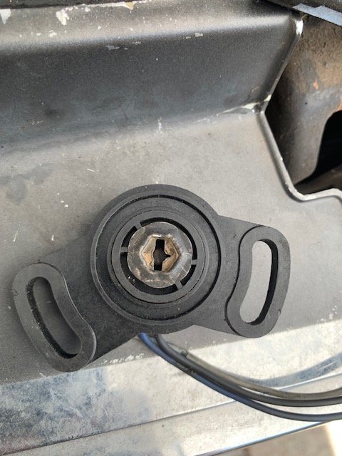

Well, Here is the results of my efforts. I pulled the intake today and ended up using one of those body capture type nuts with a flange to make the adapter. since it was stamped sheet metal it was easy to carve out using my drimel and a small file.
I got it installed, had to space out the TPS slightly but it works. got it semi-wired in enough to test and set. here are the photos.
in attempting to set the adjustment as per GM spec, I am finding that the throw the throttle has seems to be more than the TPS. the TPS does not max out at its stop but when setting the idle position at 0.50v I slowly open the throttle and will reach max voltage of 4.88 at a little over 3/4 throttle open. I can continue to open the throttle fully and the voltage remains a 4.88v

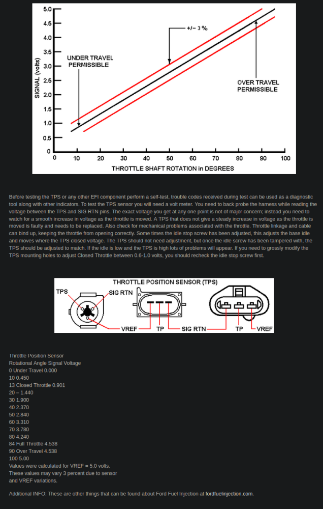

I found this online stating something about "over travel" I'm not sure if this is what I am seeing and is normal. @Will L. Have you run into this when setting and testing a TPS?

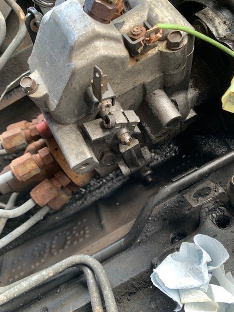

Well I think I have found the issue here. removed the cruise cable and throttle cables. both seemed to travel with ease, I lubed them anyway with some dry lube. what I found was when I completely removed the return spring from the IP. the end looked as though it had been re-shaped on the hook. I pulled the return spring on the 6.2 I have on the stand and immediately found that the one on the truck was about 1/4" shorter than the unmolested one on the 6.2 engine.
Installed the spring from the 6.2, this along with the extra resistance from the cable controlled TPS from TCI was causing the stiff pedal. Now it seems "normal" to my foot!!

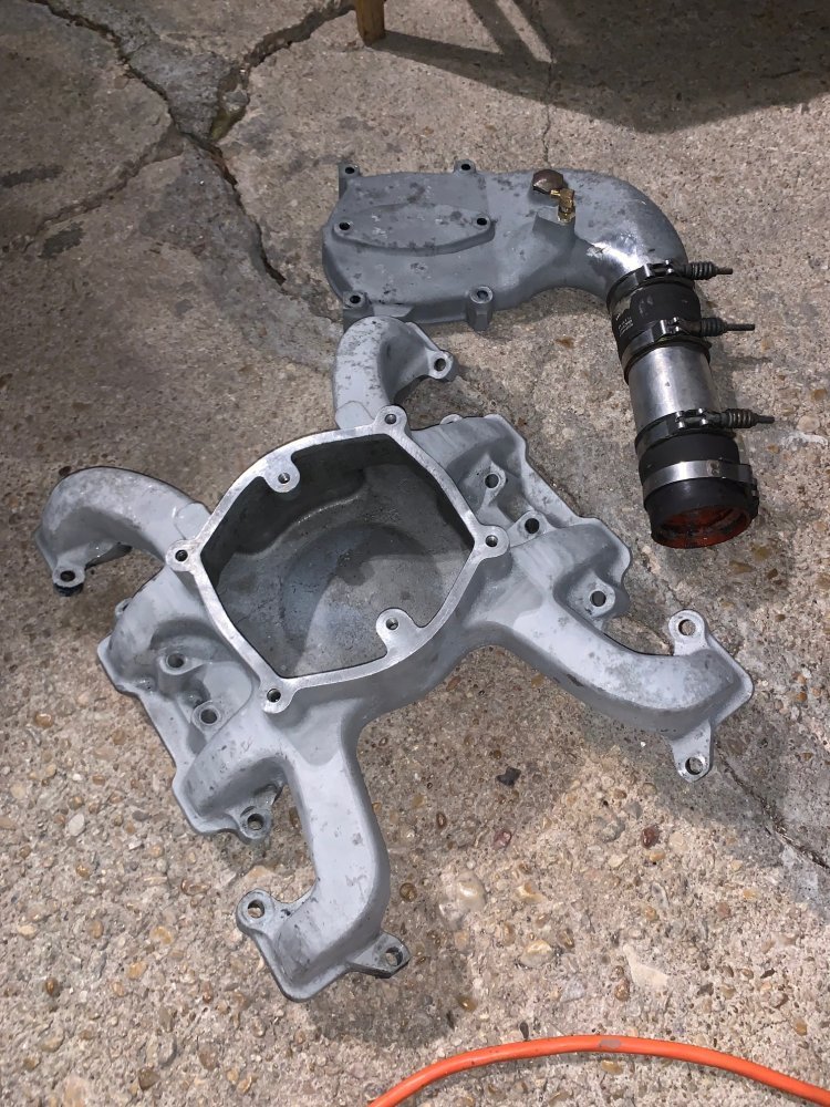

While I have the intake off, I want to replace the fuel hose to the IP that lives under the intake and clean things up a bit and tidy up the wire loom. might even use some paint strip on the intake to remove the black paint and bring back the aluminum color. I'm not going to get to the valve cover gaskets yet though. the drivers side was leaking but last week I snugged up the bolts which were only finger tight, that seems to have slowed the leak to a minimum now. the cam position sensor aka oil pump drive cap that's not in use is leaking but I am afraid to touch it thinking about that plastic union thingiemobob that joins the shaft with the oil pump breaking. I think I will leave that alone. Unless someone chimes in telling me it's safe to pull and use the non sensor drive that's on the 6.2 engine.
Finished stripping the black paint off the intake, now I need to get ready to reinstall.
Not sure if I should leave it bare or spritz some clear rattle can over it. the upper intake has some blemishes on the aluminum. thinking about taking the wire wheel and giving it a shine. again it's gonna get dirty and oily again so I probably should leave it alone and bare.

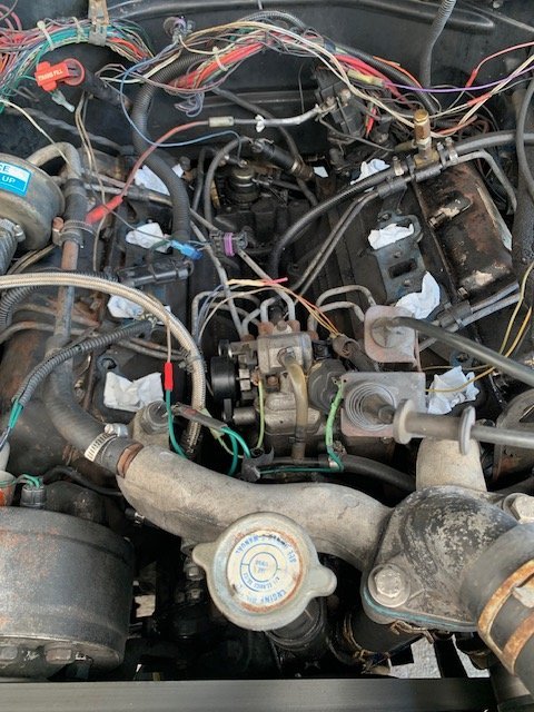

Just finished getting it all back together. need to test some of the wiring I re-did yet. I re-did the complete harness for the TPS and CPS since the connectors were right next to each other. I had previously grabbed 5v from the factory PCM to power the CPS, now it's tied into the 5v feed from the TPS which comes from the TCI tcu. Now the factory PCM should be completely isolated and out of the equation.
Under and over travel is just saying out of parameters. On the 6.2/6.5 it has alw been just set it to 5.0v at full throttle then check idle is within range.
To be fair, checking it all along the range is the best to know it isn’t having a hiccup along the way but I just slowly move throttle from idle up, then back down and watch that it is a “smooth” transition. I can’t remember getting detailed enough to check exact numbers unless there was an oddball problem in the rig. In my experience tps is either spastic, wrong at idle or wrong at wot. Never had tk be that accurate. But my work is usually crazy old rig so a new one does it or it’s fine. Super rare failure point imo.

I did some more modifications to the GM TPS. I was having to use some flat washers behind it to space it out from the IP as the throttle shaft would contact the tps before contacting the IP housing where it mounts. today I pulled the tps back off and gave it a good look. there is a small plastic titty protruding through the center of the tps that seems to be part of the outer housing as it does not rotate with the innards. I took my drimmel and ground it down just a tad. now it's a smaller titty lol. Now it mounts flush with the IP housing and works with the adapter I made.
the drawback is the adjustment. it's maxed out on the adjustment one way for it to not set off a code in the EZ-TCI controller but when moving the throttle it reaches max voltage between 1/2 to 3/4 open throttle. I tested this with the tps in hand turning it and watching the data on the display for the tcu. I had this same issue with the cable driven tps this is also after calibrating the tps with the tcu. I am wondering if this is part of why the trans shifts hard from 1st to 2nd.
