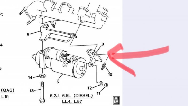

Off subject but have you changed your oil cooler hoses? Or better yet the oil cooler and hoses..the hoses fail without warning and engines bone dry before you know it happened. And when you fix the starter there's a bracket that's VERY important. Make sure it's there. Others can be more specific. I just know from these guys to make sure you have it..
Okay, I've ordered a mechanic stethoscope and will for sure pin point the location before I tear it apart. Thanks for the advice. A few years back (when the truck was my dad's), he hit a buck and the antlers pierced the oil cooler, I'm not for sure all that he had replaced. It looks like oil has been leaking around there too, not sure if it's a hose or a connection. Will plan on checking that out too.
I'm not sure what bracket your talking about. I had the starter off a couple of weeks ago and don't remember any bracket.

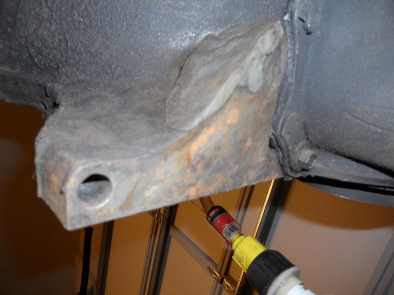

At the back of the starter there is 2 long bolts that go up into the block. At the front of the starter there is one bolt that goes to a little bracket that looks like a chopped up piece of tiny angle iron which bolts to the block.
If you are missing it, the starter can rip the ear of the block clean off turning the engine into a boat anchor. 0991378E-2DD2-4E3E-A8FA-9FB386F284DC.jpeg
Seriously JB Weld doesn't fix it.
