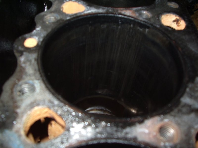

I checked the 3 main webs, and to my untrained eye I could only see one spot that might be a crack, about 3/16ths inch long. By this time it was getting so warm, and too bright, to be able to see the webs very good. So this evening when the shade finally gets back there I will try to get some pics, with my daughters help, so that others with more experience can also look at the webs.
If the webs are indeed in good shape I will then remove the heads to see what I find on that side of the block. My next concern is the condition of the rings, pistons, and cylinder walls. I pulled the glows to see if there would be any evidence on them to tell me more about what the "lifter knock" might actually be. I could only see extra carbon on the third from the front on the passenger side. Everything else about them seemed to all be the same. They are Bosch Duraterms with no more than 20K on them. Later I will test them to make sure they are all working properly.
