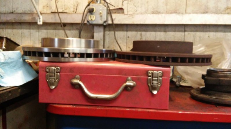

DRW on the left, and SRW on the right, you can clearly see theres ALOT more meat i nthe DRW rotors but they are the same exact height.1231151330.jpg DRW on the left, and SRW on the right
