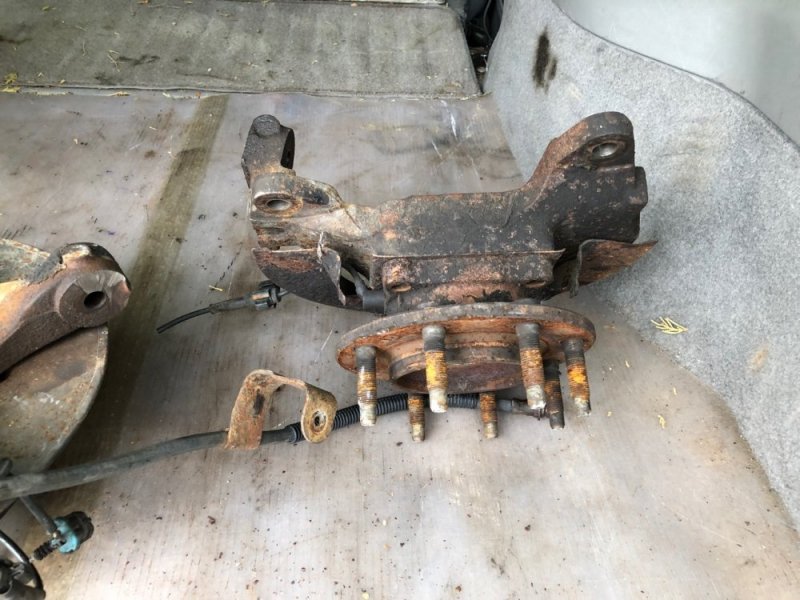

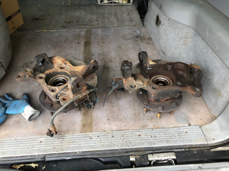

I may have missed it in the various threads, but can I replace the 8 bolt hub with a 6bolt hub to fit my 2019 wheels? I picked up the spindles of a 2500 4WD yesterday at the pick and pull, but I would need to replace the hubs.
The GMT 800 era bearing hubs for the 1500 attached with just 3 bolts vs 4 bolts for the 2500.
Sounds like I got a paperweight for my 2hrs of labor plus cash. Any market for these? And does this mean that for my 99 Tahoe, any of the 6 lug NBS spindles will work if they have 4WD?
