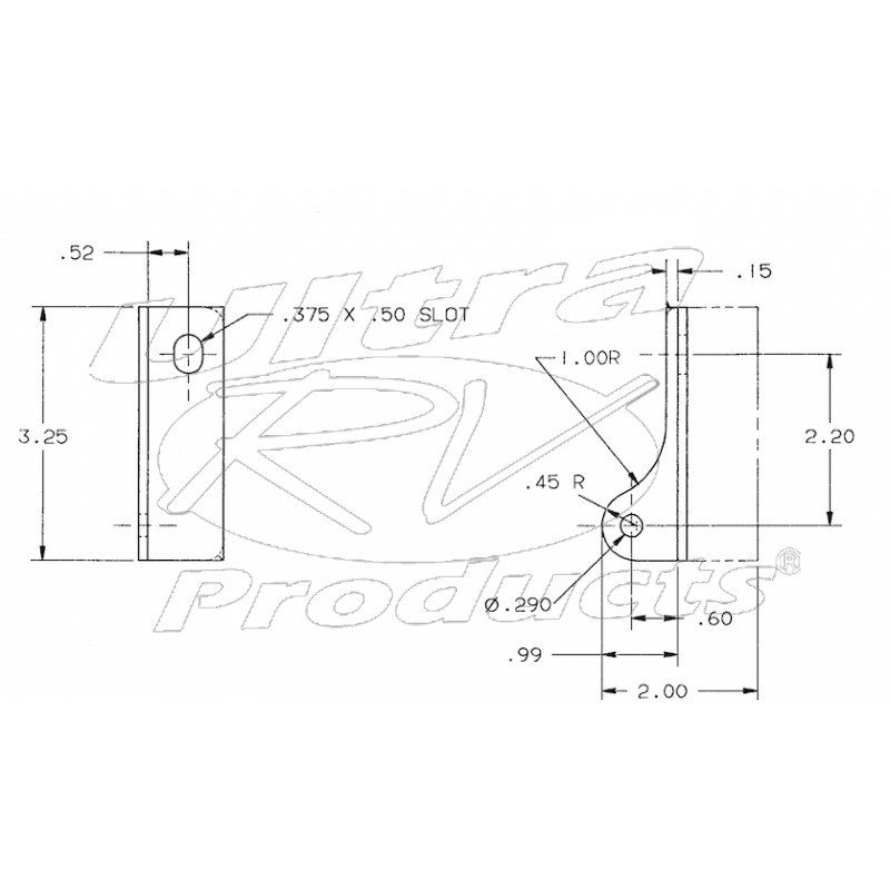

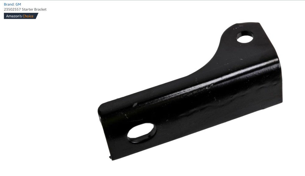

absolutely! and it's much lighter in weight too. You still need to make sure to install the rear bracket though. When I installed mine and started the truck for the first time I was in wow factor mode! spins over faster and sounds like a cummins cranking over.
