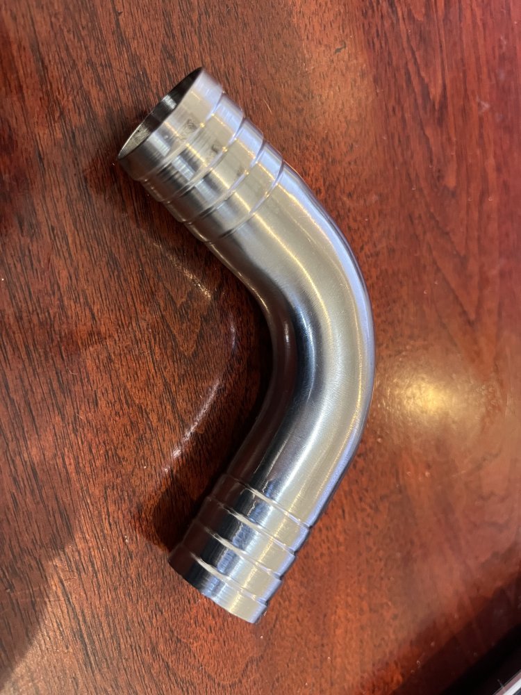

So I got the 1” elbow that I intend to install in the passenger side valve cover grommet:

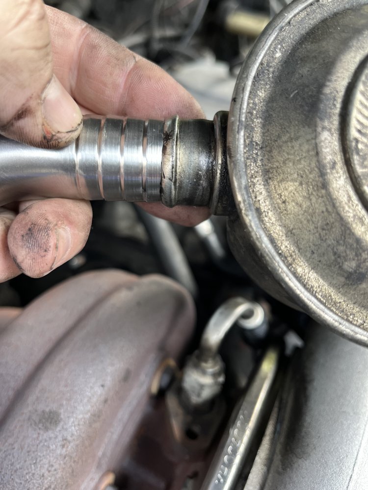

It fits loosely in the grommet. It lacks the exanded flare on the pipe from the CDR:
Elbow is about 1/16” smaller than it needs to be for it to fit snugly. What are my solutions? Can I use a pipe expander on stainless, or will it just crack? Could I find a grommet with a slightly smaller opening? Could I slip a rubber sleeve over the elbow?
Just thinking off the top of my head, how thick of a wall is 1" pex or similar tubing? maybe heat some plastic tubing enough or some of that clear rubber hose over the elbow and cut it flush with the elbow end. then slip it into the grommet while still hot. the grommet will be tight but will make itself a grove to sit in and stay in place as the tubing cools down.
edit: if you use some black rubber hose, use some of the vulcanizing goop used on tire patches on the surface with the grommet and it will adhere to each other like a solid piece.
Yeah I was thinking black rubber hose, but just getting it slid over the stainless tube would do the trick. Not sure I would need vulcanizing goop. Anything I can get on it will result in a tight fit:
It was that or sorting trough PCV Valve grommets from Dorman to find a tighter fit.
What about that old style electricians tape that when you wrap it onto it's self it basically becomes one piece? I can't remember the name if it, but from the look of it in your video you don't need to take up much space between the grommet and the pipe.
I was also thinking about that epoxy putty or steel putty that you can form around the pipe. shape it how you want so that it has a sort of barb or lip on both inside and out. let it harden and then pop it in the grommet.

I’m thinking shrink tubing would do the job.
Idk about heat shrink, definitely not electric tape - not even 10 mil.
JB Weld would work good. Just build up the 90° fitting on the one end and if you make it a little too thick, jb weld sands down well.
I know out in the garage I have some rubber sleeves made for cooling systems. I dont remember if they are for adapting radiator hoses or heater hoses.
You might check with the parts stores and see if they have some sleeves such as that.
Different hose built for different chemicals. They don’t withstand oil.
Some oil hoses don’t withstand high heat.
It’d hold until a good substitute is found.
Or use an oil rated hose to fit the EL and stretch it over the CDR fitting.
Find oil rated hose to fit the CDR and double clamp it to the EL.
IDK if there is oil rated hose that would have a neck down like that.
Might also be possible to find an EL that is larger on one end. Even a plastic EL.
