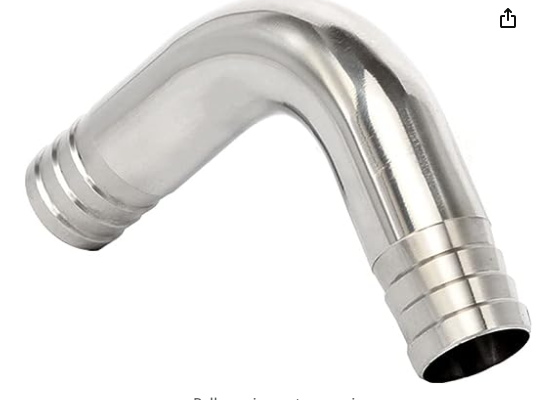

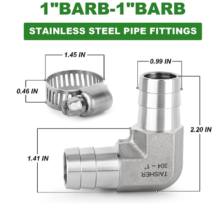

If you cut the cdr, I don’t think the piece will be long enough to secure a hose onto.
I would buy a double ended barb fitting. One the size of the cdr nipple, the other the same size as the provent hose nipple. I’m not near mine to measure either cdr or provent.
If you can’t buy a one piece double barb fitting, then buy the two required sizes, with npt threads on the other side then screw them together using teflon paste or even rtv.
Do not use the entire cdr as the fitting as it’s restriction will fight the provent. Also you don’t want that immediate 90° fitting anyway.

Measured the CDR pipe and it's a 1" OD.
So which of these would you go with:
