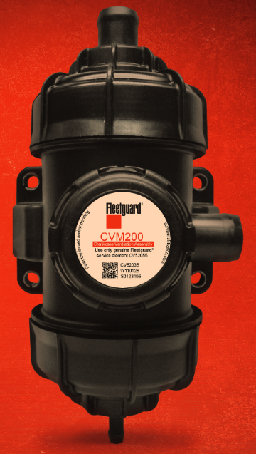

I have been looking up different CC filter kits online and checking cross references on CC filters we keep here at work for the equipment trying to find housing assemblies they fit. I ran across the Fleetguard CV52035 and 36 which look like a decent fit. they don't seem to have a valve installed in them, reading the tech data on them. unfortunately I couldn't post the PDF's I found on them due to the upload file size limits. I still have to check pricing and availability for them and their replacement filters though.
if you all get a chance to google them, let me know your opinions. Here's a pic of one and its filter inside.

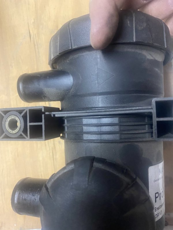

I just posted on Bison’s thread:
Bison hooked up the provent backwards. Wish I was around then to have helped him. Only pointing this out for future readers to know. The valve cover tube should have went to the top and the vacuum side (turbo inlet tap) goes to the bottom. Look in the picture I post and I am pointing to an arrow made into the provent which indicates direction of air flow. Also you can watch this video from the mfr and notice which one they connect the valve cover to.
This is why Bison always had pressure, and what he probably wasn’t aware of is the coalescing filter would not work anywhere near as well as it should have. I would be amazed if it removed half the oil it should have.

I knew something was off with Bison’s with the mention of having any pressure at all. That is not how these work unless the can gets restriction in air flow - they operate in the negative (slight vacuum).

Look at how Bison mounted his- it is nice lookin. Except he has the two big hoses backwards. But yes he added a fitting into the oil pan (down below the oil level is preferred). You can mount it anywhere away from the heat of turbo and exhaust.
