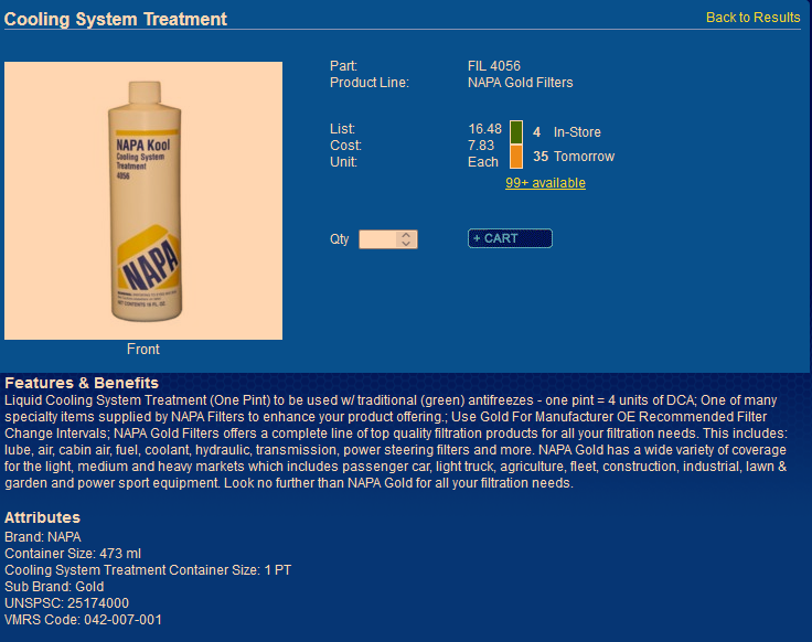

Yes, but that is nitrite in the coolant. That is a super common issue in diesels. The 6.2/6.5 does not have that issue because of our blocks and cylinder liner design. Infact high nitrite is counter productive to us. That is the problem with dexcool and all long life coolants in our system- it is devastating to our heads, it will dramatically speed up the cracking in the steam pockets between the valves, and turn to muddy sediment in our blocks.

@Will L. I didn't go wrong by adding that coolant additive from Napa with I had my radiator fixed last year? I had the plastic tank replaced on my radiator last year due to it being just rotten and brittle. when I reinstalled it I used the regular green antifreeze and Napa gave me a pint bottle to add to the coolant and said all diesel's use it for erosion in the cylinder walls! I will have to look on thier site to see what exactly it was. it was a white Napa labeled pint bottle
I believe this was the stuff they gave me I found the SDS sheet too.

Yup. High nitrates. Flush it.
Use old school green antifreeze and if you add anything else-2 bottles of water wetter that is NOT FOR DIESELS. Use the gasoline type water wetter.
DO NOT add coolant filters that have the additives either.
