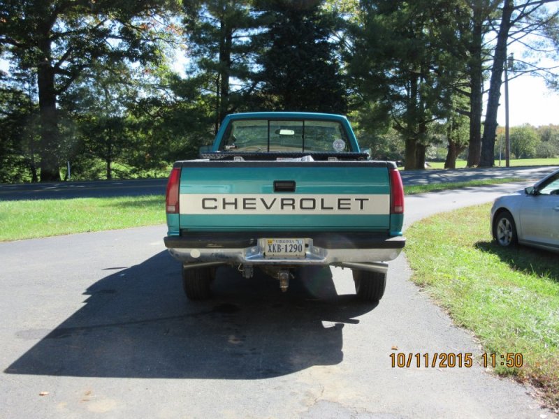

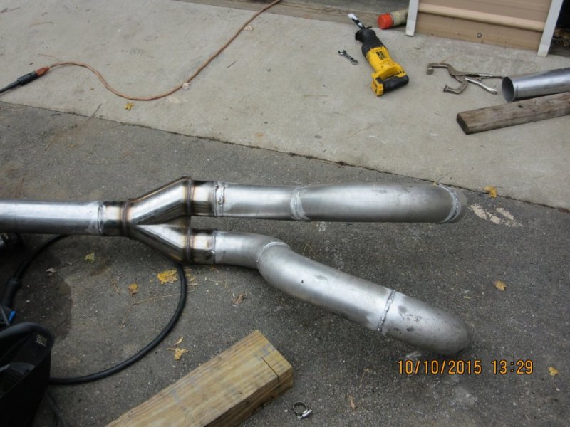

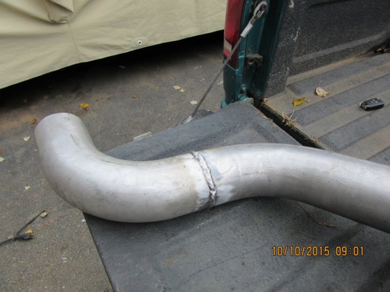

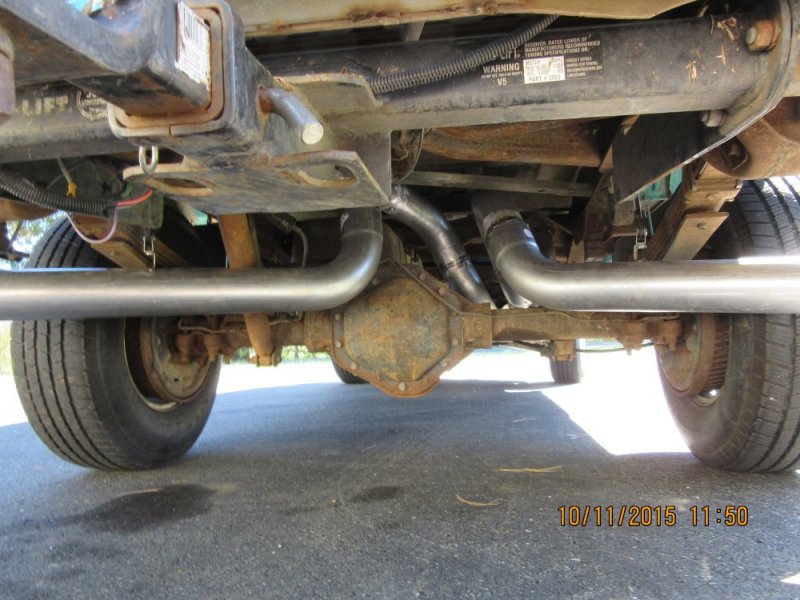

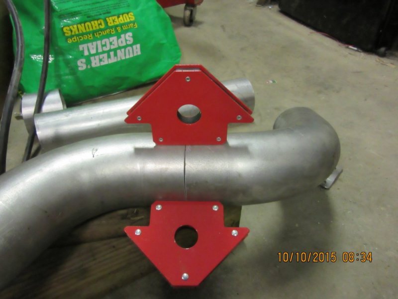

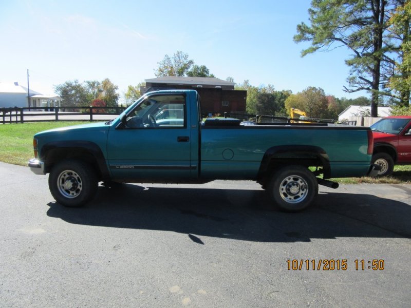

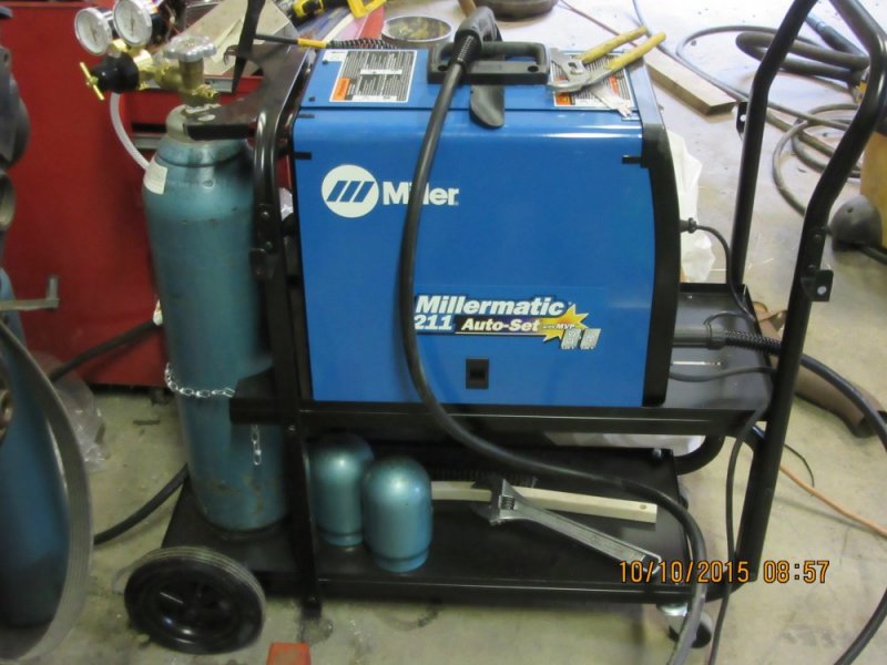

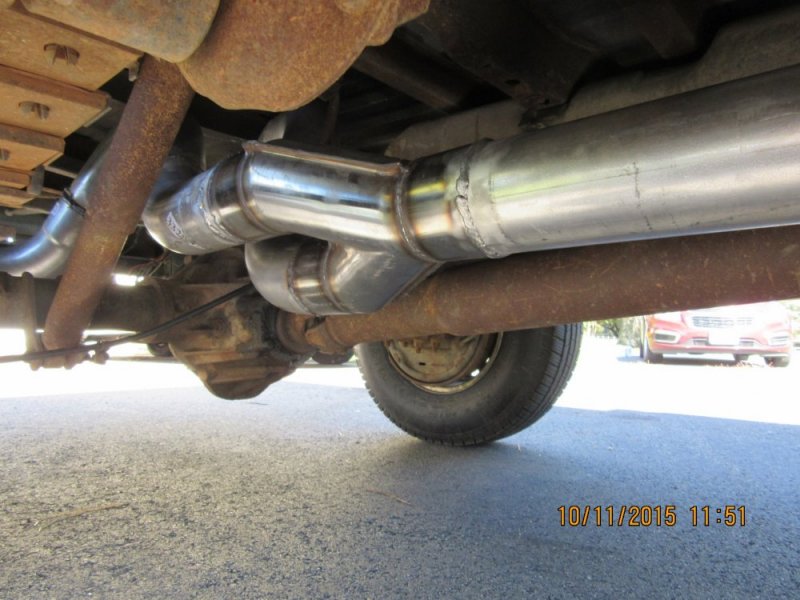

Well I have been thinking about running stacks on T for awhile but since it would cost bed space started looking into dual tailpipes. After looking at the Diamond Eye site I got the idea to use the 02-07 D Max dual tailpipe pieces. So I just ordered both sections for both tailpipes from Summit. For a y pipe I used a Dynomax y since it was $20 bucks cheaper than the Diamond Eye piece. Nice thought with it being a simple bolt on, reality was far different! It took about 8hrs on Saturday another 2hrs on Sunday but I got it in. Had to do a little cutting and pasting and the passenger side pipe is closer to the tire than the drivers side. From the rear they look pretty even. May have to rework the driver side a bit on another weekend. Also removed the muffler- never ran a 6.5 straight piped and I like it. Surprisingly for the most part it seems quieter. I also noticed a bit of drop in EGTs and it does seem to rev a bit freer. Finally I got to play with the new welder. This is the first I have ever been able to weld with gas at home and it rocks. Takes MIG welding to another level.

Thanks Jorge, It is indeed an equal opportunity coal roller!!!
I love the duals and I love the sound straight piped! I need to adjust the passenger side tailpipe so it better matches the drivers side- another project for another day!
