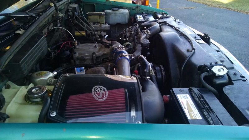

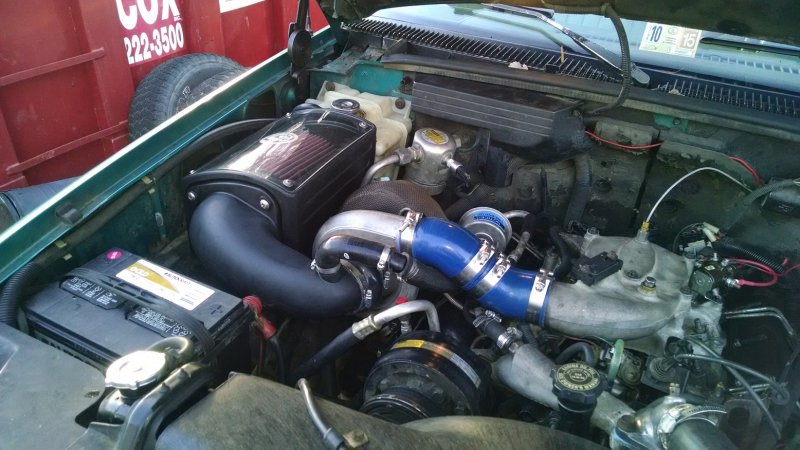

IMG_20141115_155755099.jpg IMG_20141115_155807192.jpg I got the rad in T yesterday and replaced the battery cable from the starter to the battery and the crossover. Also finished up the surge tank install from the 95. The top rad hose is very soft, no tightness. The cooling system seems to "breathe" better. Runs about the same on the gauge but she feels(all the hoses, etc) cooler when you open the hood. I was able to use the starter battery cable from the 93 K1500 6.2 and the crossover was from the 93 c2500 6.2. The volts seem to be a bit higher, before you had to wiggle the connection at the battery sometimes, it would lose all power! Got the new O-rings on the oil filter adapter and the oil leak has stopped. I took T for a test drive and really got on it- saw 16 psi at about 3/4 throttle and wound her out to 3200 or so on tach in 2nd, 3rd, and 4th, runs like a scalded dog! Egts hit about 850 and was cruising along at around 80 or so when I shifted into 5th. I also had a chance to see if I could shift her from 1st to 5th without using the gas- T was able to go from 0 to 15 or with no fuel! The tach dropped to around 200 or so in on the shift to 4th and 5th but she did not stall. Was bucking a bit in 5th when I let out the clutch but she pulled all 5 gears at basically an idle! Called Conestoga and I am set to get the timing checked/ set on Wednesday the 26th. Will asking about the puff limiter as well!
Looks nice and clean.
Thanks! My wife makes funny of me when I start wiping her down. It makes it a little less sooty when I am working on her!

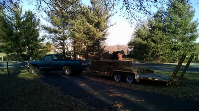

Yesterday I got a small load of hay, 25 40-50lb square bails with three more in the box and she did great. I guess it was close to 3000 lbs behind me. I was able to make rolling stops at the stops signs in third, pulling out at about 900-1000 rpms. The gas gauge did not drop much- at 450 or so on the trip meter and she is just under half a tank. 200-220 miles was pulling both trailers!

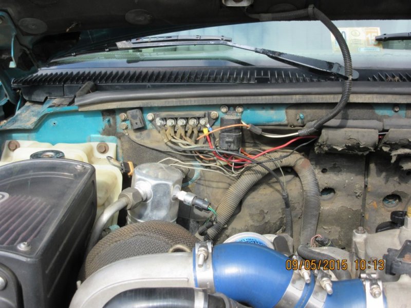

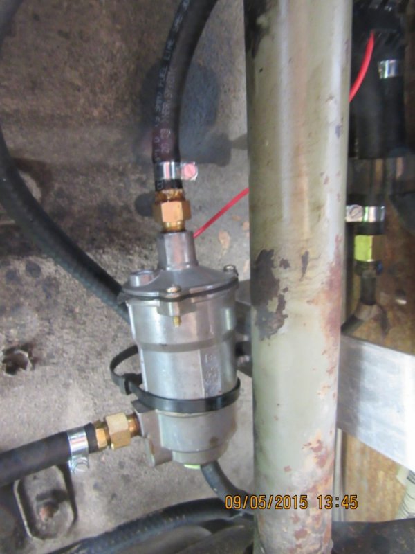

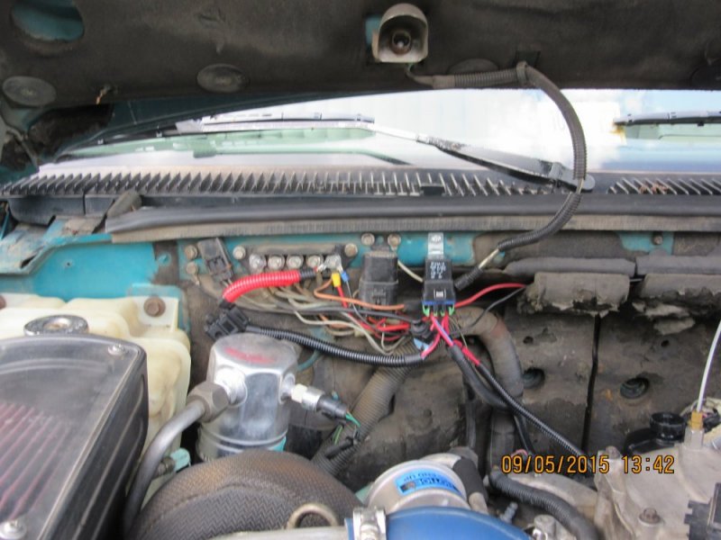

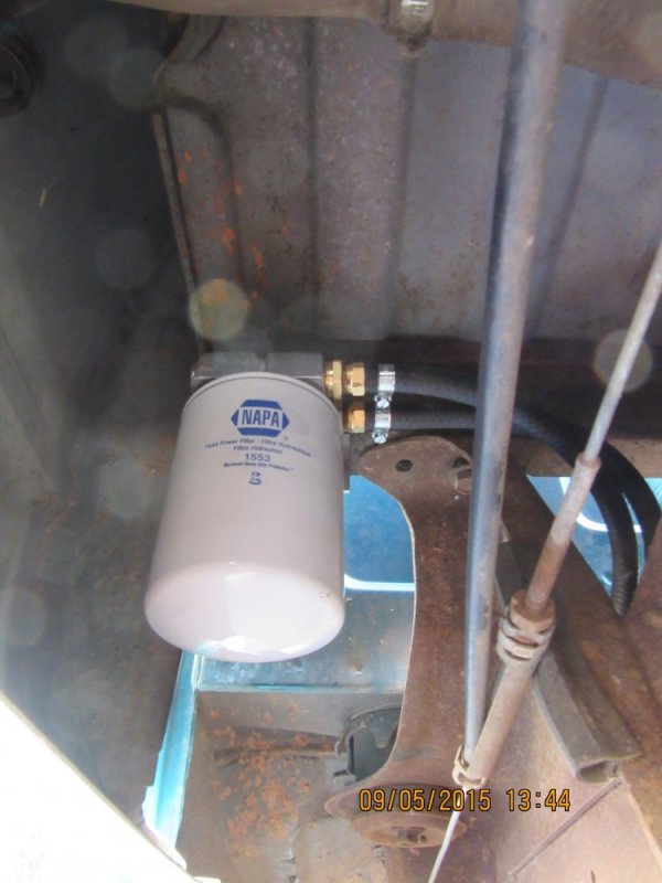

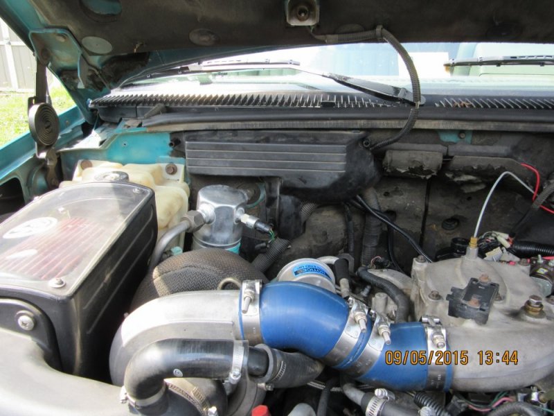

IMG_0807.JPG IMG_0809.JPG IMG_0810.JPG IMG_0811.JPG Finished getting the new Walbro pump and fuel filter setup on Saturday. I also installed Leroys lift pump harness- went on in less than 10 minutes and has now been added to my list of essential mods. I have had three trucks with intermittent to no lift pump function and this in combo with a good aftermarket pump seems to be the cure all for faulty lift pump operation!
No problem. I wished I had known about this harness when I wired Little Ds LP to a manual switch.
Initial impressions in driving are the truck now feels more peppy. Builds boost easier, smoke less below boost, accelerates easier, is louder, idles better, and finally it lugs better. Much happier with the way it feels below 1500 and it smokes less there as well. Need to put some more miles on it but so far it was worth the work and the cost! I suspect it has never gotten fuel consistently from purchasing last year.
Update: got fuel before heading out on a weekend road trip last weekend and got 20.7 mpg- that is with a small leak in the fuel system. Had issues with the fittings on the Walbro. Came with 1/4 npt 5/16s nipples and had to get some 1/4 npt adapters that were then joined to a 3/8" hose barb. They leaked so finally broke down got the correct 1/4 npt 3/8 hose barb fittings.

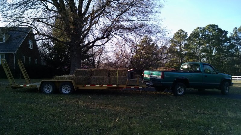

She did great in the trip up. Running empty up Afton mountain on Saturday with the AC on at 88^ and muggy cruise set at 75 saw a spike of 12psi on the ATT and the EGTS peaked at 950 then settled in at 850 or so and about 10psi. ECTs stayed steady 2 ticks below 210 the whole way up. All in ran great. After a 200 mile round trip on Saturday through Sunday (stayed over nite in Lexington) we came back and picked up 30 square bales on the 18' flatbed trailer. Still have well over half a tank of fuel!!
Talked to Mel at Connestoga and he said the Ferd guys with Holley red fuel pumps are having trouble keeping up with the Moose pumps. Thought the Walbro might have some trouble but I knew so many 6.5s were running the Walbro with success I thought I might be ok. I can now attest that the Walbro will not keep up with the Moose at heavy throttle applications. Was running her hard Friday evening before we left and experienced fuel starvation after an extended run at 3/4+ throttle at 80-85mph and 10-12 psi. She started bucking a bit and almost shutoff. Guess I need a bigger pump. Good news in average driving and towing situations the Walbro does great and in general she runs much better. Never had the first issue on the recent trip.

To the beginning: I had a surge/ stumble/ buck issue. Spoke to Mel thinking it may be the pump. He suggested fueling. I agreed on the face- 6.5 fueling systems suck. 5/16 line, tank sock, crafty lift pump wiring, cheap lift pump. I have had fueling issues with 3 out of the 7 6.5s I owned and or driven extensively, mostly from LP wiring. I decided to eliminate the variables so to speak. Removed the sock, FTB, Walbro, Leroys LP harness. So now (pretty sure) I know it is getting fuel. I now have zero issues at light to medium throttle and I only experience issues (surge/ stumble/ buck) after extended applications of heavy throttle- basically a mile + of foot practically to the carpet with heavy acceleration to get there. I do have a heavy grey haze at heavy sustained throttle openings and heavy dense black smoke when I lug it. I was thinking a fuel pressure gauge to evaluate and or quantify the "lack of fuel". As you I cannot figure my mileage. That almost 21 is tooling around the backroads, in town, with very little sustained interstate driving. I am not sure why the mileage is so high. What are you guys thoughts? Am I on the right track? gauge the next move? Very happy overall but it is a killjoy when you want to have a bit of therapeutic fun and then she hacks/ stumbles!
