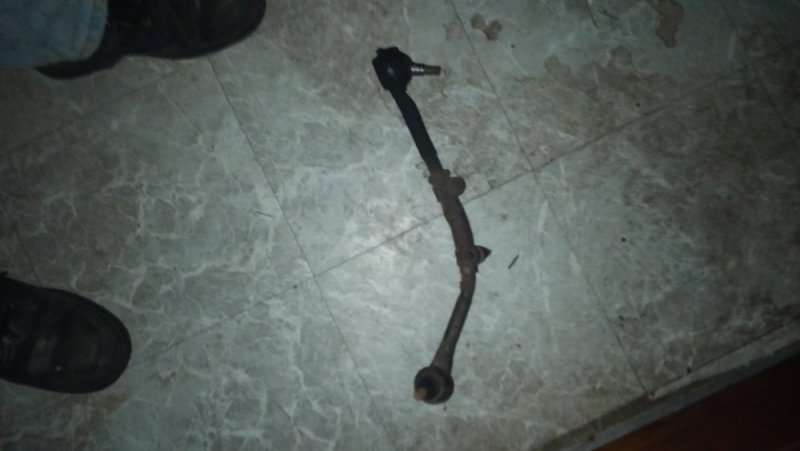

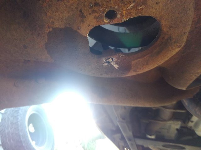

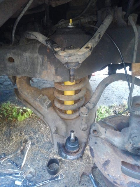

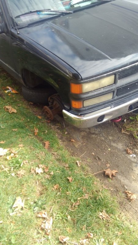

Yeah just got a a/c delco lift pump. Ain't got the cash flow to spend that kind of $ on the FTB. And she's still got the original injectors and glow plugs I think. I know I have not changed them...There probably shot but not much I can do about it at this point. I should get to pick- a -part and get another fuel tank though. Lately I've been having enough trouble trying to keep the front end together.. busted two ball joints in two weeks.. both times I was over 50 miles from home had my wife with me and it was late at night both times so thank God I have AAA... Otherwise it would have bankrupted me just to get it towed... And a major flaw with these trucks.. lower ball joint breaks the truck comes down and lands right on the tie rod every damn time...So right now she really needs a front end alignment cuz I had to basically count the threads the best I could to put the new tie rods together.

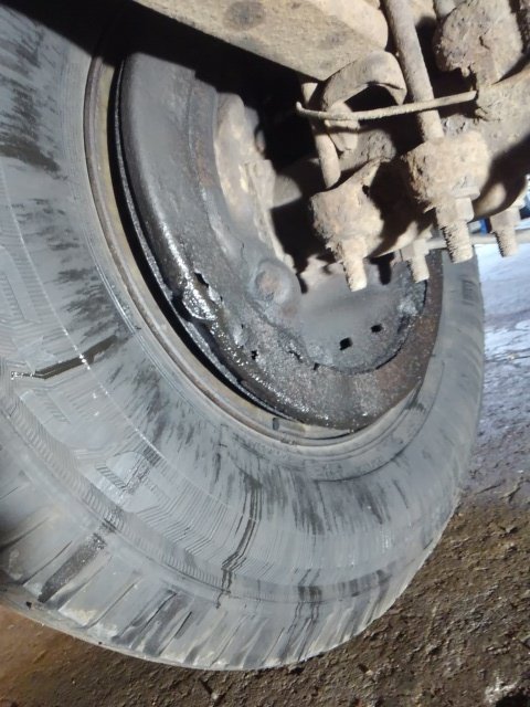

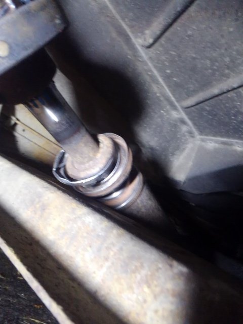

These are some other probs I've had in past month or so.

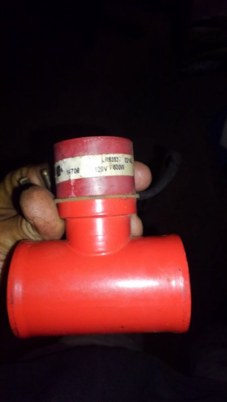

Have any of y'all ever used one of these block heaters... And if so are they a direct fit in the lower radiator hose?
You're talking about the ones that go into freeze out plug hole. About what do they cost? Can't be that hard to put in right.
Yeah has one but I don't think it works anymore. Because I can leave it plugged in and that truck still cranks like hell trying to get it started when it's cold.
