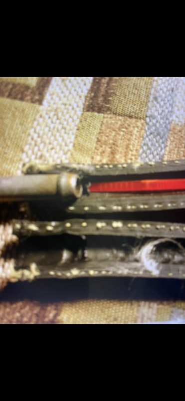

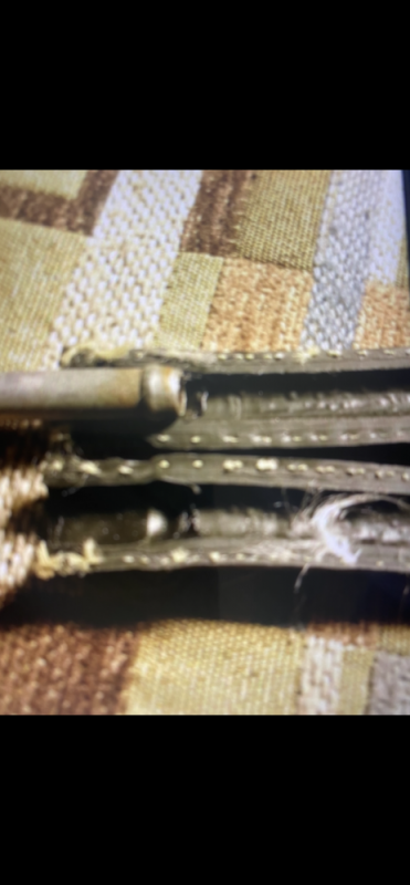

So the lift pump sucks fuel from the tank and pumps it through the filter and to the injection pump. If the lift pump fails, the injection pump can suck fuel all the way from the tank, but it is super hard on it and wears out the injection pump quickly. It usually does damage to the head and rotor (the 2 expensive parts). This damage happens for both ds4 and db2 pumps- thats why I push for a pressure gauge so bad. Anything in the line anywhere restricting the fuel will create the problem.
My favorite picture to show why the fuel pressure gauge should be tapped via all metal on the ip is showing a rubber hose flap inside the rubber fuel line that attaches directly to the ip. The cable tie is pointing out the rubber flap that caused “ip failure” issue when the ip was actually ok. Even with a fuel pressure gauge anywhere else in the system it would have looked like fuel supplyis good when it was the cause. If a certain someone wants to fes up to ownership of this pic...ok. Otherwise I will just say thank you and keep using it as a teaching tool.
