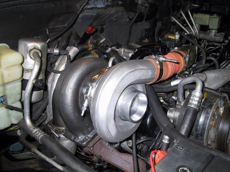

It is an A team turbo. I am pretty sure it'd be a copyright infringement if someone used that pic without walking J's permission. I only posted the pic cause walking j is a site supporter. You can see the pics in their ad. http://walkingjdesigns.myshopify.com/products/6-5l-diesel-turbo-charger-a-team
Yeah, I know it's an ATT. I was just surprised to see an ad with this exact same photo. As I read the article, I suspect that it might be a misrepresentation. The ad says it's off a 2001 6.5. With that pic. Which has a passenger side AC compressor.
