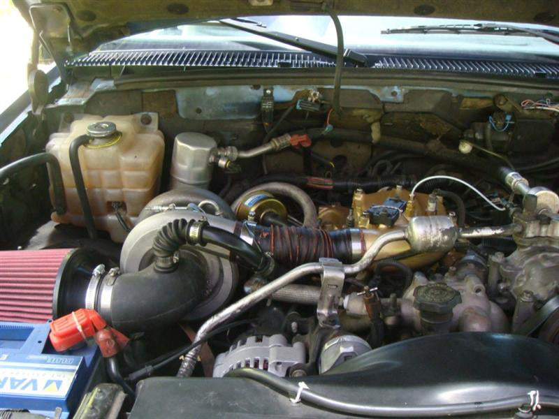

I did drive down to Yakima Washington, It's only 200 miles and Bill personally installed the ECM as well as gave me a free T/M since I had my home made version on it. Right now I have my turbo listed on craigslist for 350.00 including the T/M. Maybe someone will want to upgrade their gm-4. I did write the ad to say that if they put a deposit on my turbo then once the ATT arrives then we would complete the sale:thumbsup:. One further question I have is are people shortening their intake tube from the stock turbo. or is it a direct fit. Ed
You cut the stock upper intake plenum back about 6". A silicone hose is provided with the ATT but I and some others have used a couple hump silicone couplers and a piece of 2.5" pipe to connect them. Otherwise you can also find long 4 ply silicone hoses that would be more durable and smoother on the inside, but cost a little bit more.
Pictures of mine in post 67 and throughout this thread. It works equally well with a GM or ATT.
http://www.thetruckstop.us/forum/sh...her-project-or-two-and-finally-the-ATT./page5
The one 90 degree elbow is off a Cummins set up and it flares to match the Peninsular intake's 3" dia. opening. I purchased it from Diesel Depot, GA and it is manufactured with an 1/8 NPT opening on the top edge.
I was driving through Ellensburg and Bill retuned my GLE program to better suit the ATT, which is why I call it the GL4+.
so I see, seems to be 3 different hose setups. me thinks I prefer version 2.
