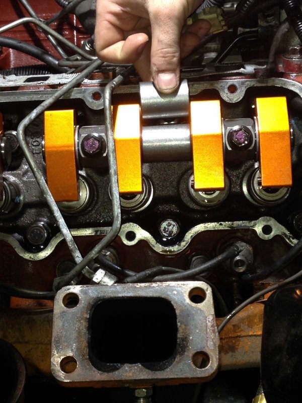

Just in case anybody is curious, here is the side-by-side of the original spacer and a freshly minted correct one.

So they sound different? Does it feel like it runs any different, like any smoother or quicker to rev? I couldn't believe how tight my middle ones were though honestly it still wasn't that hard to turn the engine over with a ratchet, so maybe it won't make that much difference when running.

Have too few miles on the rockers to really notice any differences and motor is still in the break-in stage. Specifically, rockers were installed ~150 miles ago and now have ~30 miles on the corrected spacers.
In terms of the sound, at first I thought one of the pulley accessories (A/C, hydroboost, etc) had developed an issue, but yesterday I noticed the sound definitely came from both heads. Timing of when the sound started did coincide with the rocker's installation.
